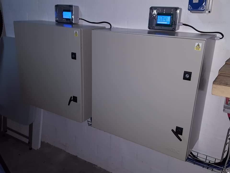

I'm running 95% off-grid at my house with 8kw inverter with 14kwh Lifepo4 storage and 2.9kw solar. On a good sunny day it generates close to 3.5kw my pv Array. I got a solar geyser but it got the element interlock with my inverter and grid. So on a good sunny day I dump my extra solar to the geyser to boost it warmer in the winter. I can control all this stuff via my phone. I'm using a Shelly EM in my DB setup with CT clamps so I can check my power use in my house, control my geyser and checking temps.

I went the DIY root with Lifepo4 setup because it was way cheap. Pylontech 3.5kwh units starts at R20 000 and you can only use 3.2kwh and max discharge is 75Amps for a few seconds. You need to add more to get better performance out of them and then it get expensive. There more other brand to and local brands to. It cost met about R18500 per unit to build it with all the stuff. I got a smart BMS inside that i can check all the info via my phone or the screen and adjust settings on it. The hardest that I have pulled out of my 2 units was 138amps combine. Did a bit of testing.
With our new born in the house and a fix bathing time and load-shedding Saturday and cold weather, I just warmed up the geyser with the storage power.  ;D sorted.

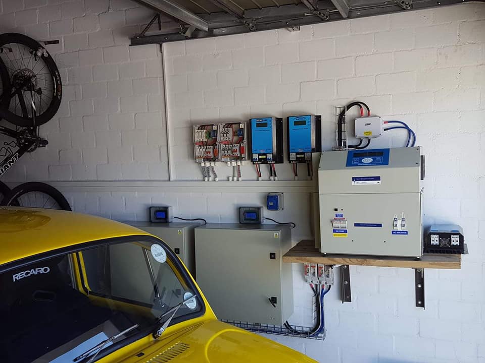

The fan on the inverter here (there are in fact 2 fans) is quite loud, but luckily its in another room about 10m from where I sit.  With the door shut I do not hear it

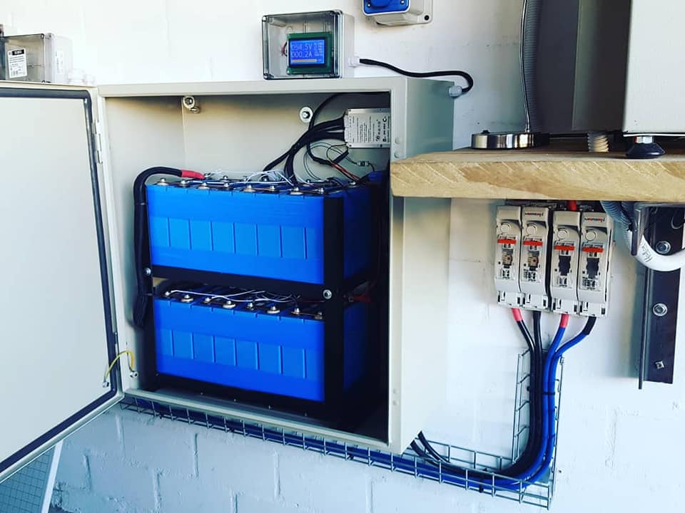

I bought my present battery from Blue Nova in Somerset West.  It has a 10-year guarantee and is in a stainless steel enclosure, with circuit-breakers on the front and battery condition indicator (voltage, state of charge)
Since 2016 I've gradually added more house circuits and have several plugs, which power an AVR, TV, Apple TV, Dstv, 9 x 5 to 7 watt LED lights, an electric blanket upstairs, all the house lighting (seldom more than 20 watts on at once), CCTV cameras, DVR, switch, fibre ONT with router and a new fridge.  One of those Bosch ones that uses 65 watts
During the day the PV panels supply all the current and also charge the battery
There is also a 2-pole 3-lever changeover switch, in case it fails
The battery:
The front panel of the battery:

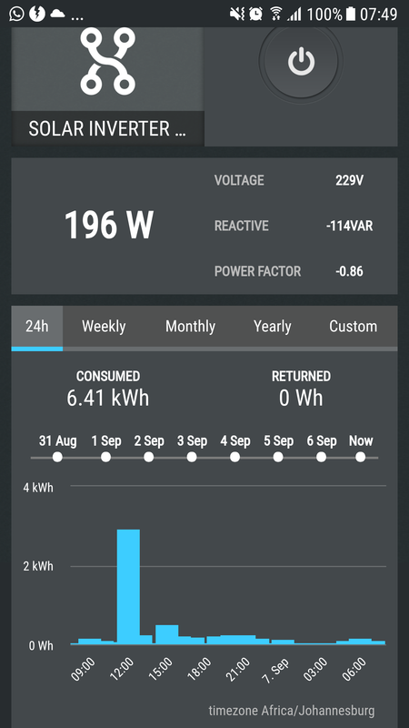

The display of the inverter.  This shows with diagrams where the power is coming from and battery and mains voltages.  And the load (25%)

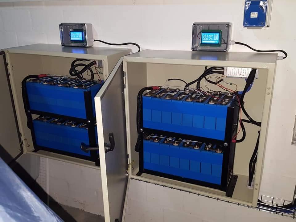

That looks really awesome @chrisc Please post a picture of the inside.
I got some photos of there units open. Will post tomorrow.
