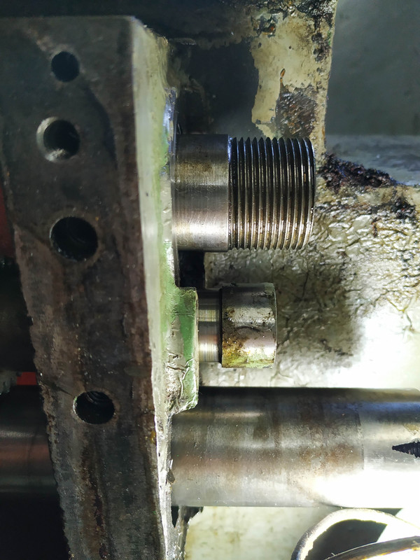

Onto trying to get the feedshaft and the leadscrew removed.
I did not have the correct C-spanner to remove the lock nuts at the left hand side of the leadscrew. I dug around in my toolbox and found that the piston ring compressor's key fits perfectly in the slot.
I will rather punch against this key before I hit the slotted nut. It has already been damaged quite severely so I did not want to cause more damage.  Two very sharp punches and she was loose. The key to hitting something to get it loose is not to use force. Do not try to hit hard as you will create flying spanners and bent stuff and most probably blood flowing. Simply hit it with a very sharp motion. Not a good looking "sharp" but a very quick flick of the arm. You want momentum to loosen the item. Not force.
On this topic. Momentum is the product of the mass of the hammer times the velocity it is traveling at. The formula is as follows:
And the force applied to the object that you hit is the differential of the momentum with regards to the period of time during which the force is applied.
This means a sharp blow will apply a lot more force in a short period of time than when you hit slower and try to hit hard. A simple applied mathematics lesson!
The other nut of the locking pair then simply can be unscrewed as well.

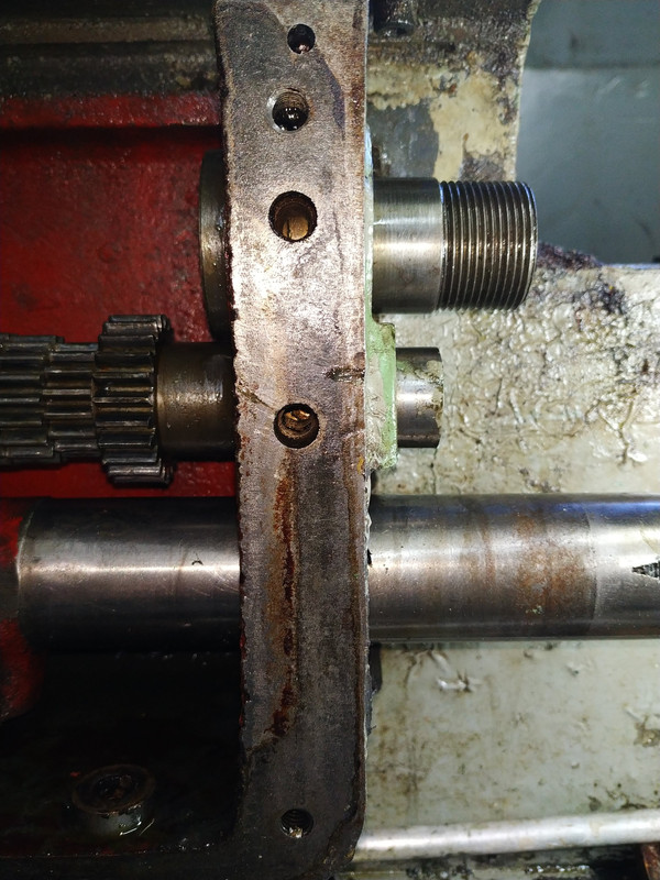

Turning my head back to the carriage this greeted me ...
Apparently this thinghy is called a wormbox. It is not mentioned anywhere and nobody online has ever seen one on a Colchester Student before. So a new name was given to my lathe. It is now called the "Funny Student"  ... I do not think it is funny ...

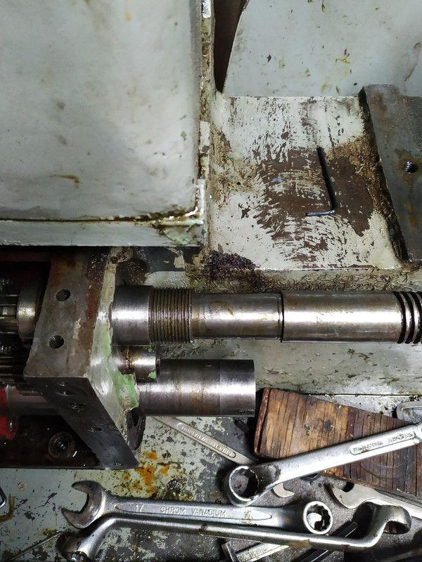

So the feedshaft is removed and I still have no idea as to how the leadscrew is to be removed.
I watched the video again and the only real guidance there was how to remove the tumbler locating strip. It is that black metal strip full of holes I tried to loosen a few days back. The guy in the video showed he undid the cap screw by inserting the long side of Uncle Allen's key into it and turning it loose with the short side. He must be very very very strong ...
OK, let me show my strength...  :boxing:
If it breaks, it breaks is my motto now. So I took the longest ring spanner I had, and hooked it onto the long side (yes I am chicken Chuck) of Uncle Allen's key.
I took a deep breath and pulled the spanner. Nothing. I turned it until the key was bowing like a bow, ready to shoot an arrow into the wide yonder. Nothing. Stuff this I said and I pulled it some more and with a loud snap sound the spanner came free. What broke? Spanner is fine, Uncle Allen's key is fine and the cap screw looked like it turned!!  :2thumbs:
Its mate got the same treatment after cleaning the cap screw hole carefully. It tried to beat it's mate's releasing cry and came loose with an almighty snap sound.
The strip was still laying solidly in place. A tad lazy I if you ask me, so I gave it a bit of a tap with the dead blow hammer.  :whip:  It woke from it slumber with a slight sliding motion.
And out it came ...
The two spacers did not move, so I let them be as they could be part of the casing. A bit of time datum advancing proved that they are actually loose, but were just gummed into location. More later when this time meets future time.

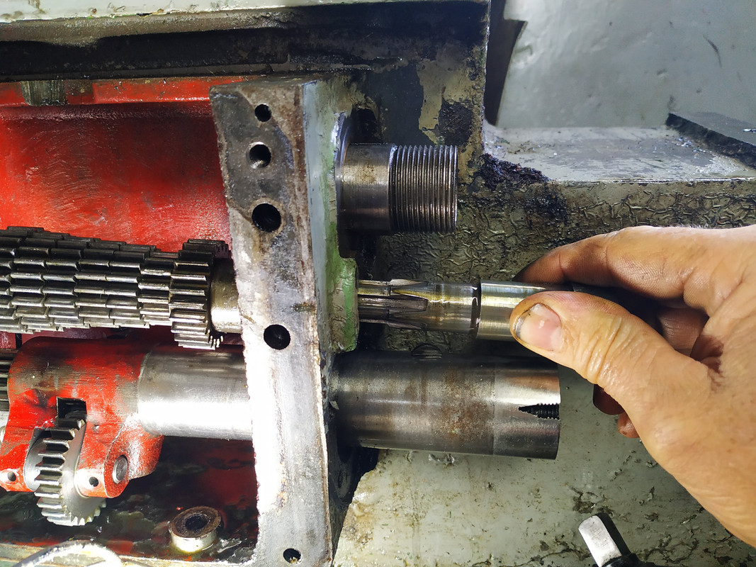

What next? Nothing ... I simply had to find a way to get the leadscrew loose from the gearbox. I took a very strong light and looked carefully. On the left of the gearbox wall on the shaft that forms part of the leadscrew line is a slotted coller. It looked more or less the same as the two that were on the feedshaft and allowed me to gave you a practical mathematics lesson.
OK, my friend, if you are slotted, you must be able to turn. I took out a very goog quality screwdriver and gave it a firm sharp tap.  :yawn:  Yeah, OK ...
Low and behold, it moved! Tap, tap and more tap and then some more. Slowly the leadscrew moved towards the right until the nut unscrewed completely.
Once the nut was removed I could start moving the leadscrew towards the tailstock end.
It was a wiggle of the apron, the leadscrew, the apron, the leadscrew, the apron ... OK, you get the drift. A fine dance it was without stepping on each other's toes. When the fat lady sang, the apron was resting on the blocks, and the leadscrew was laying in a ditch at the back of the bed. What a night it was!  :be:

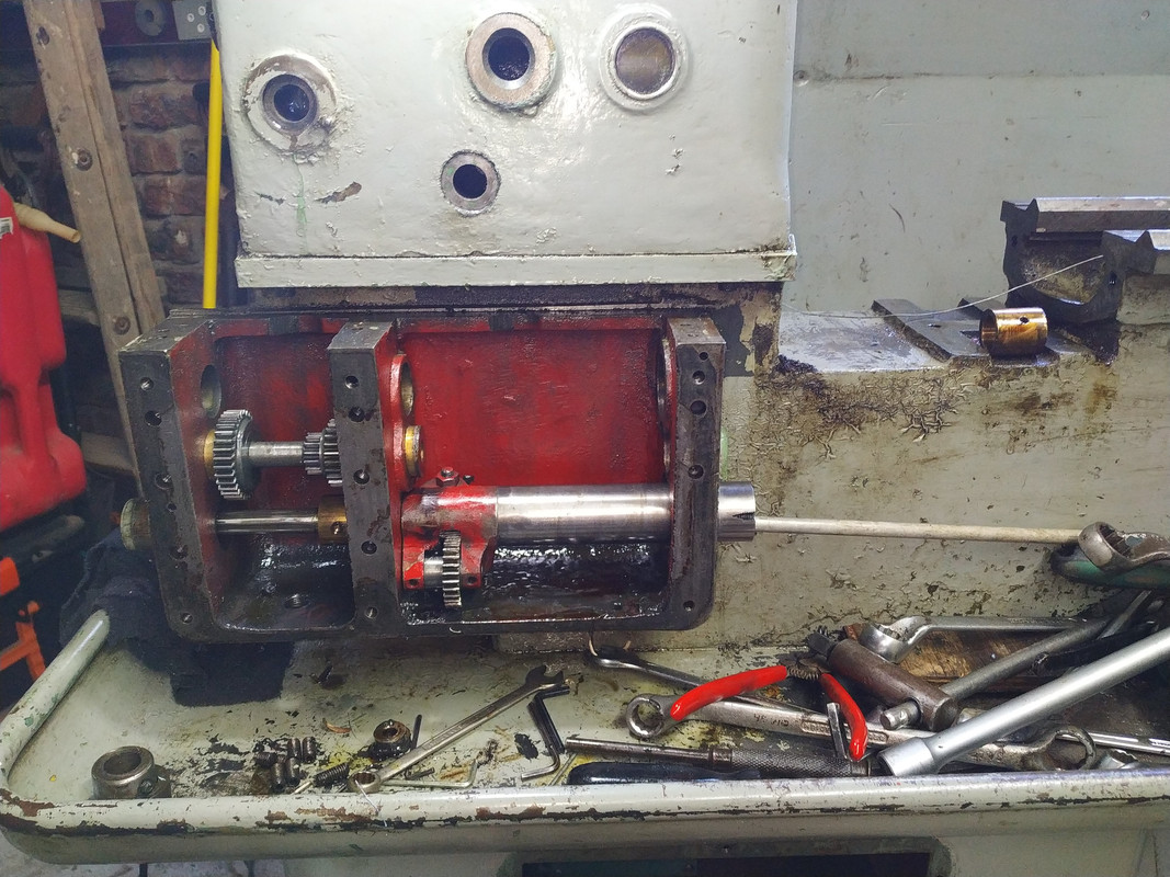

Finally I could start stripping the gearbox!  :Whoohoo:

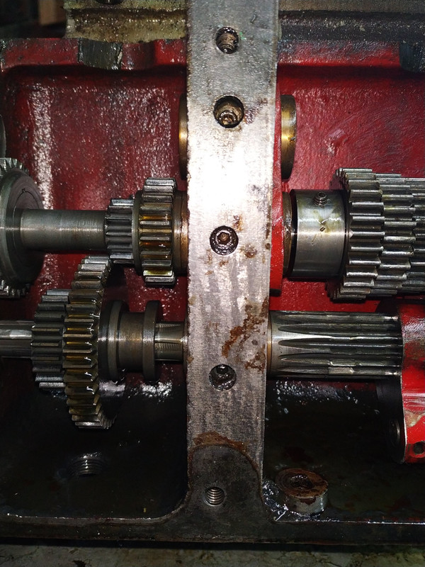

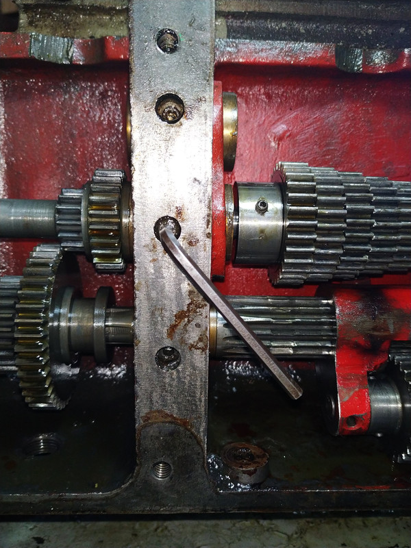

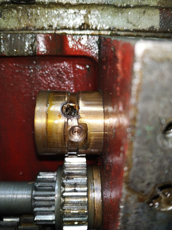

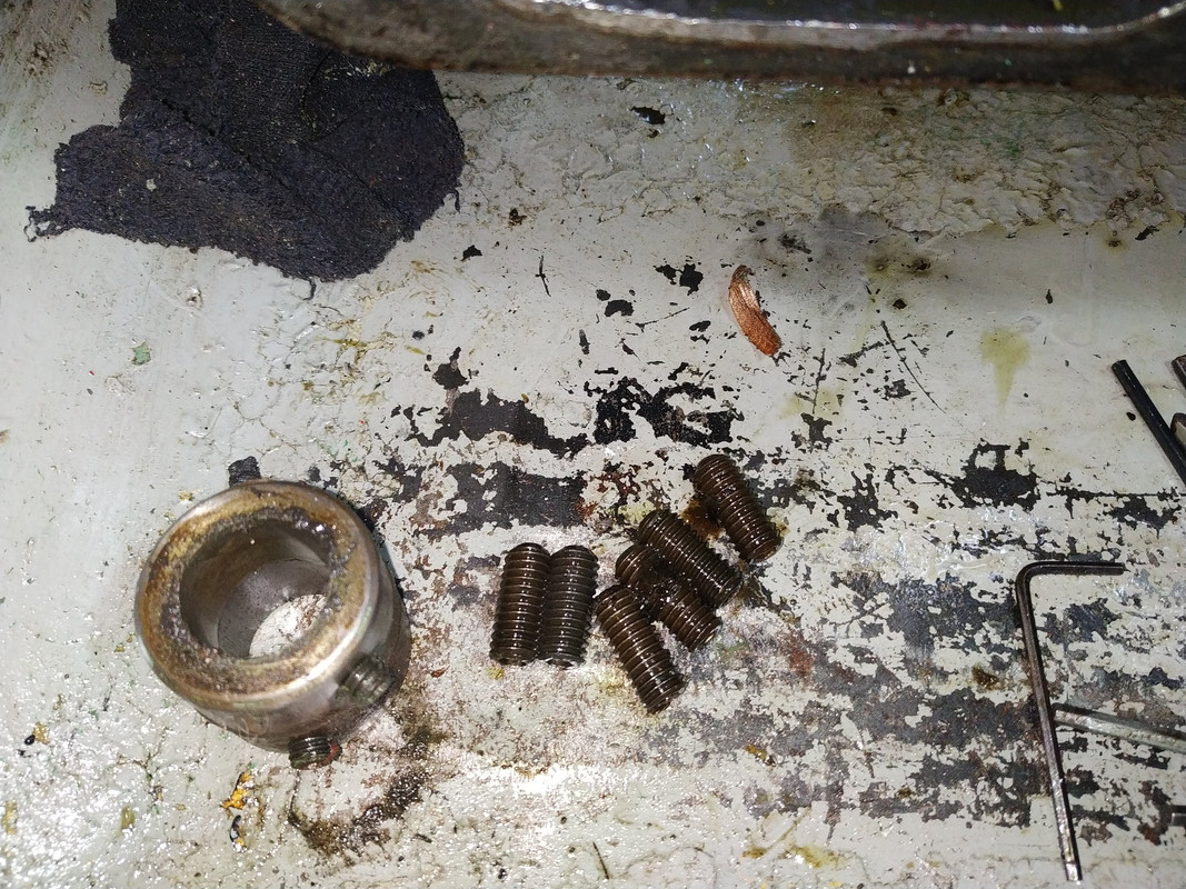

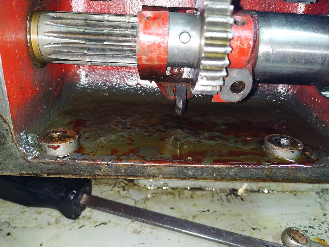

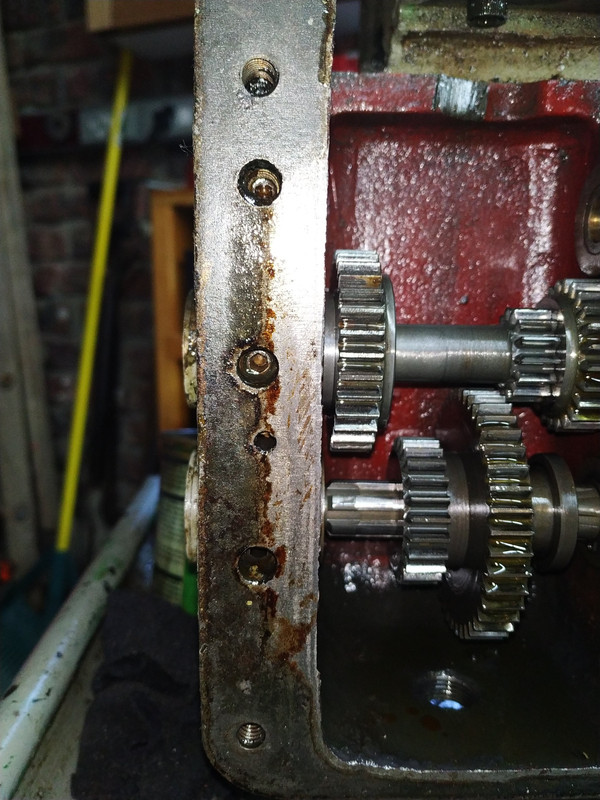

Watching a few more videos on YouTube! I saw that there are grub screws in the vertical support sections of the gearbox. These hold the bushes in place. To remove the bushes, you need to remove the grub screws.
Can you see the grub screws?
No, neither can I. Seems like our Brutish Butcher was here ... "Hey, there are some grub screws left over!" ... "Well the lathe is working, so chuck them". Sounds familiar someone??

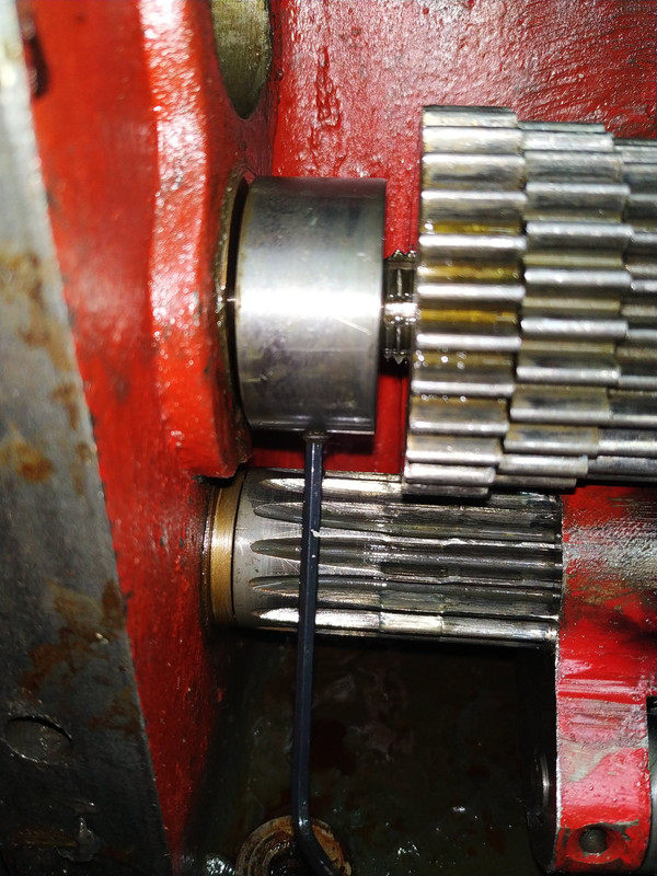

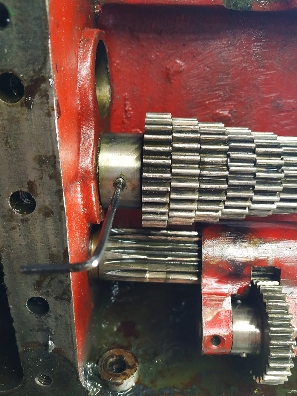

Moving onto the central vertical support. Yeah, there are the beauties!
And the left most support? Yebo yes!

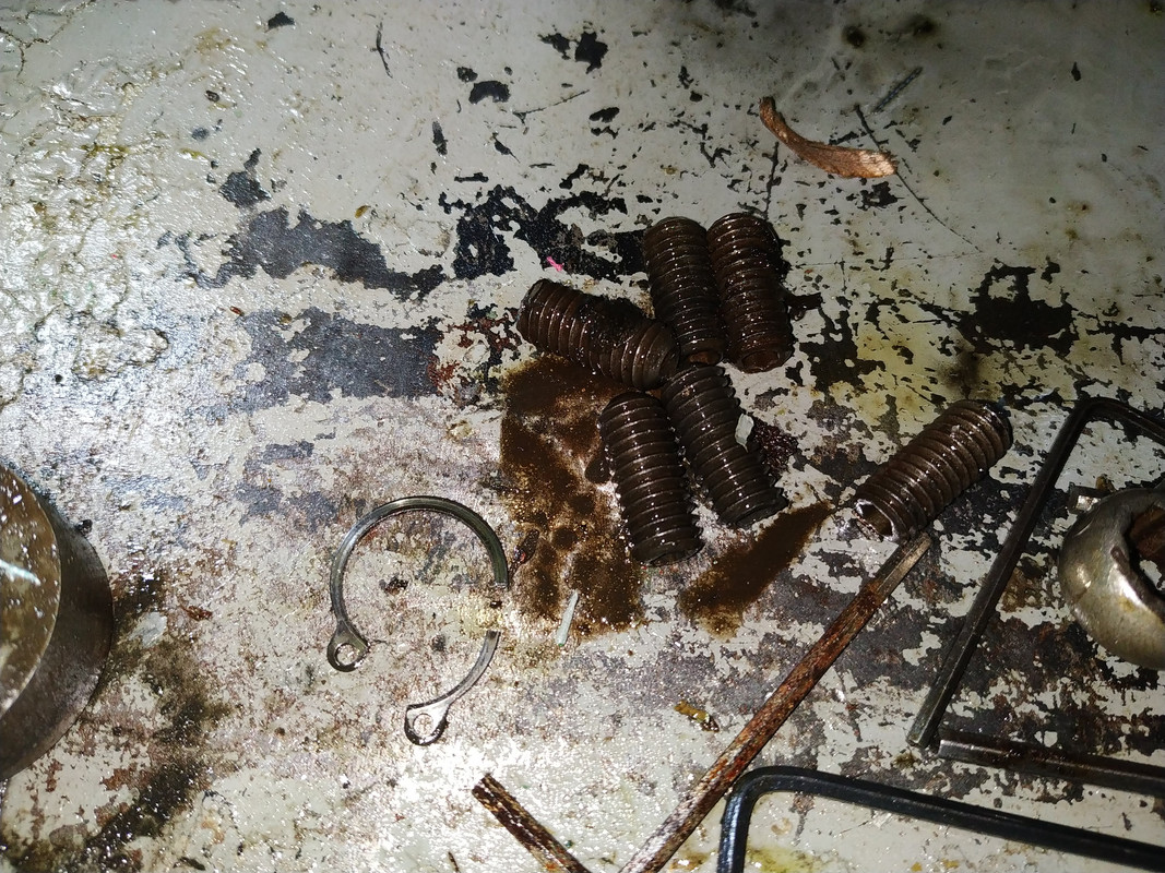

Off we go to Uncle Allen to find one of his keys that will fit. Out came the grub screws.
There the sad family lies. Sorely missing two of their kind. The collars are the two end ones for the feedshaft. The ones with the nautical or aviation connection.

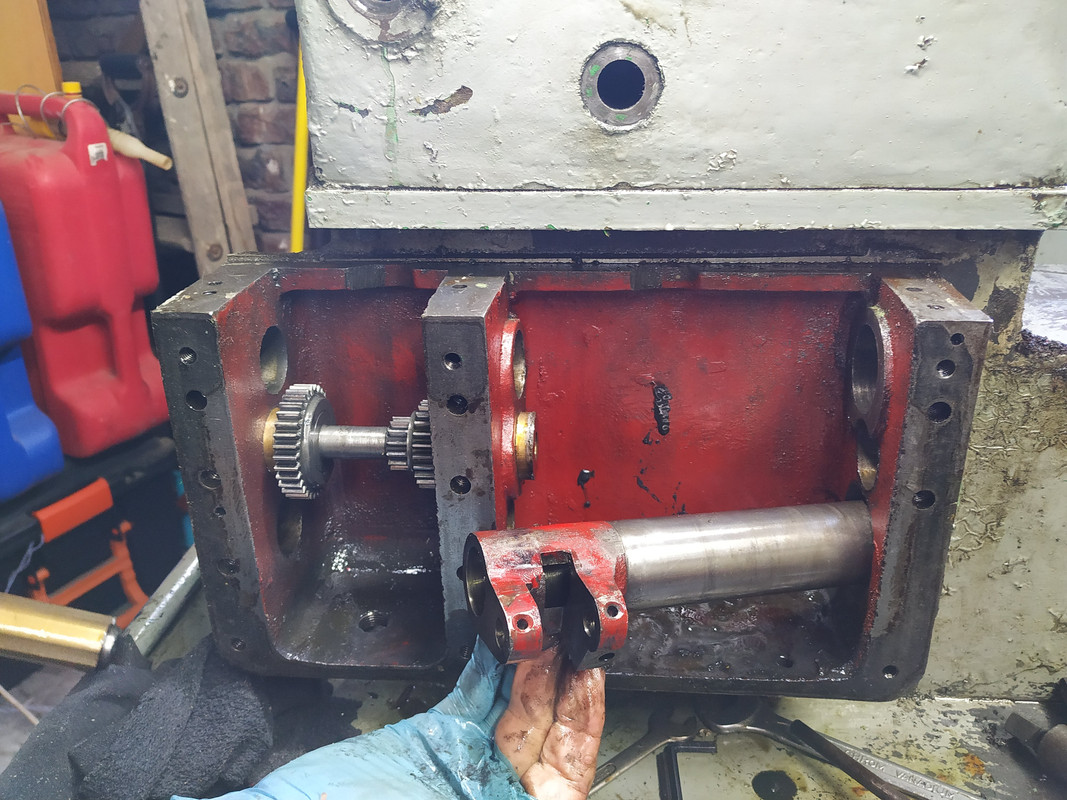

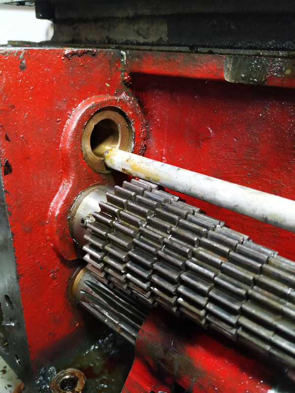

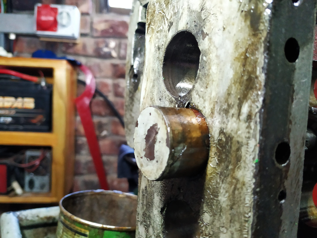

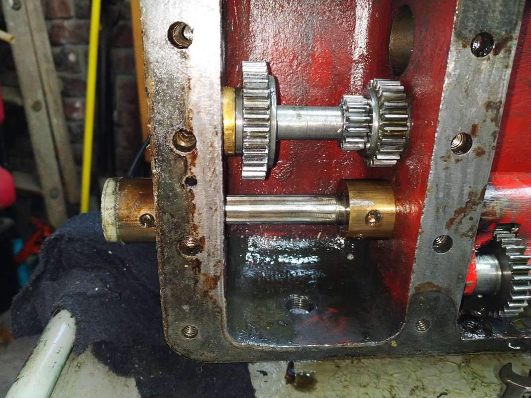

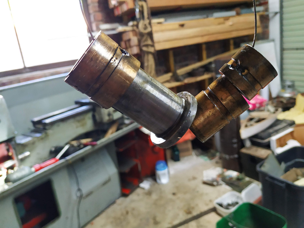

Next step. I want the bushes removed, so lets do that. Taking my aluminium rod I first tapped the central one out. It came out quite easily.
Then the right hand one.
Here they are. All strung up djou Honour.

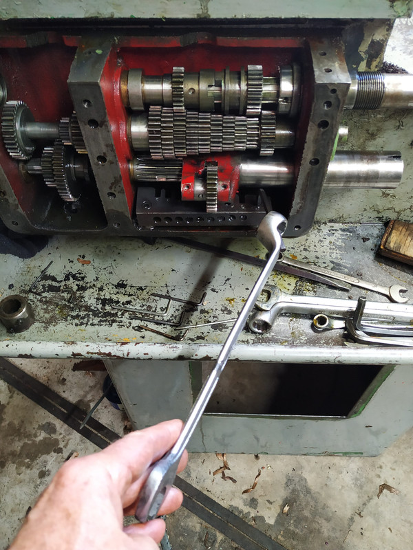

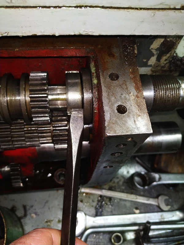

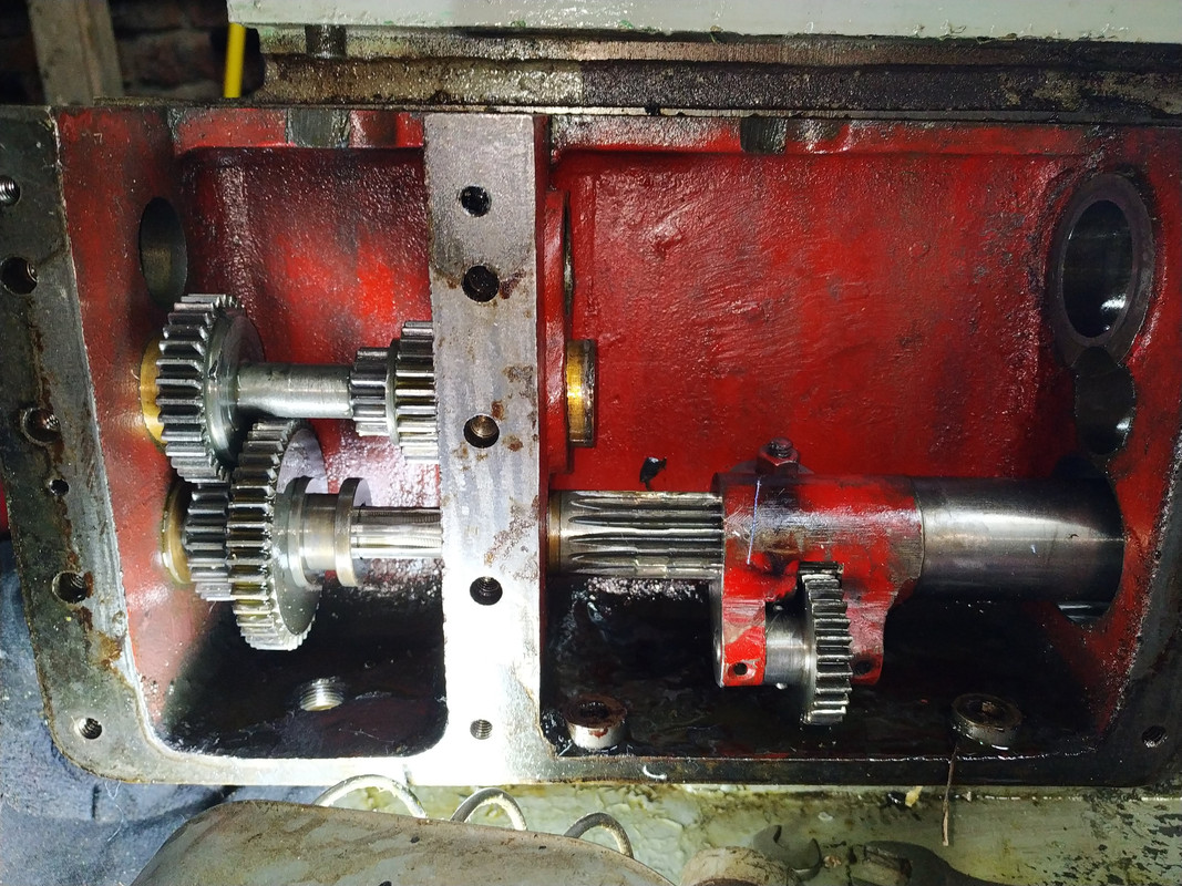

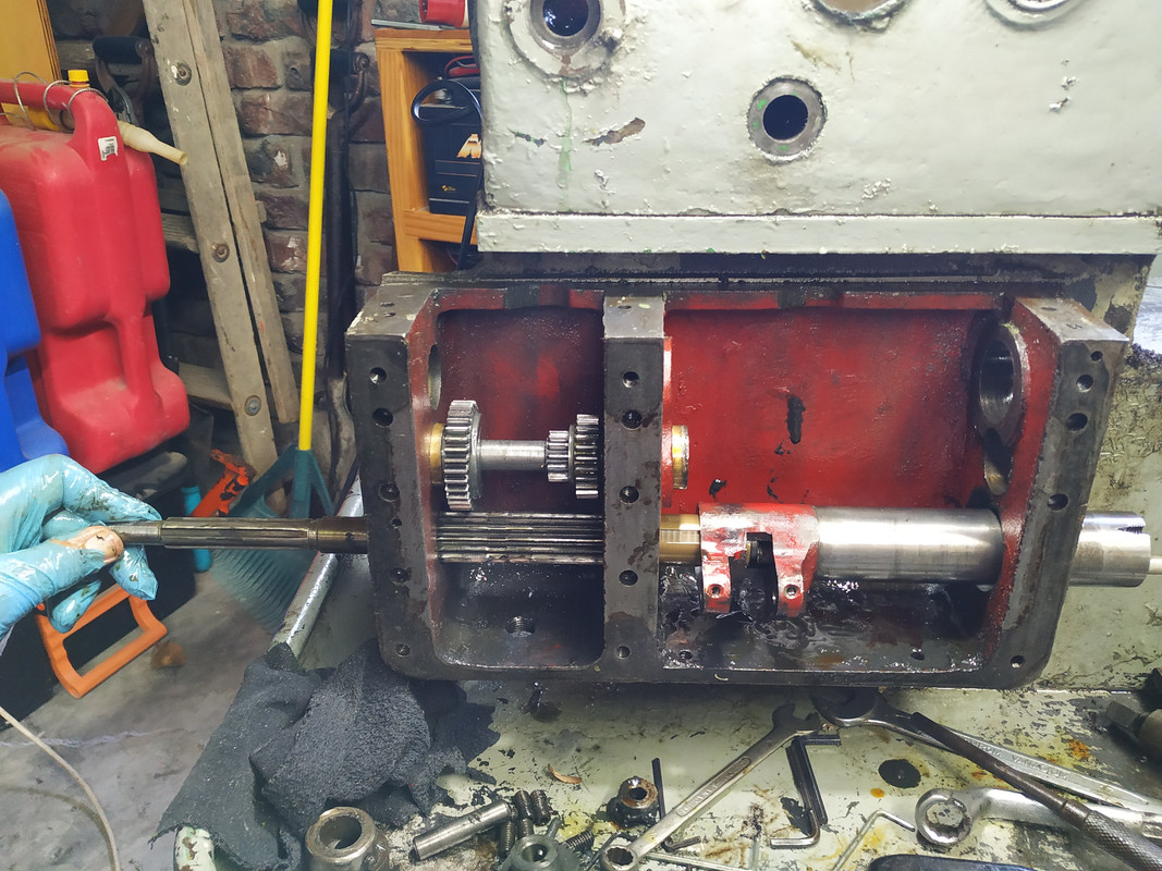

Onto getting the middle shaft and gears off. This shaft is called the coneshaft. On the left is a collar with a grub screw which I promptly undid with the help of Uncle Allen.
I stuck a screwdriver between the collar and the edge of the shoulder of the shaft and gave it some leverage. It moved, no it did not! Looking closely I could see some thread! Aha, got you you sneaky  :angel:  Turning the collar with the Allen key
I could then simply pull the shaft to the right by hand. Weird feeling not to have to tap a shaft out!
Three shafts left!

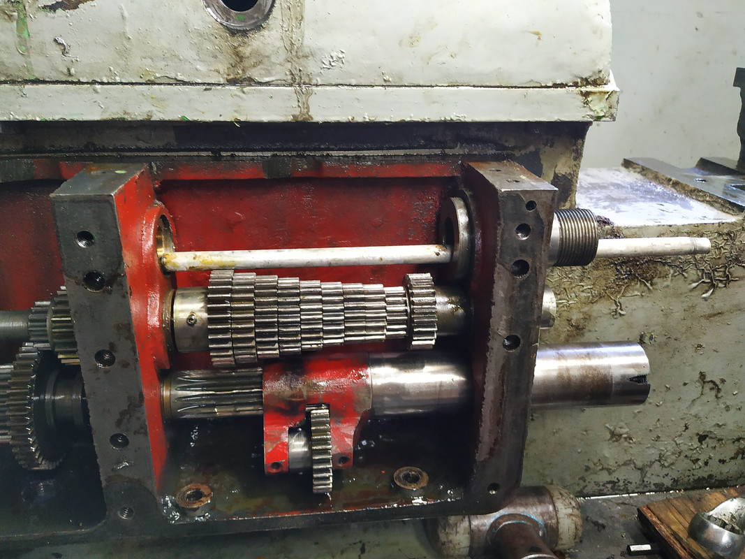

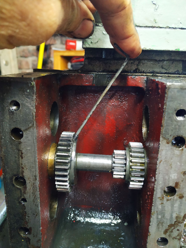

Onto getting the left hand bottom one out. Hang on, looking at the parts list this appears to be one shaft that runs the length of the gearbox!
I moved the gears to the left and hello! A circlip appears.
And promptly breaks ... ai toggie.
OK, what now?
Watching the video it appears that you need to tap the shaft to the left hand side and it will take the bush with it, both moving together. So I started tapping and with almost no effort the bush started moving.
And promptly made a solid noise and refused to move. Hmmm ... time for some coffee ...

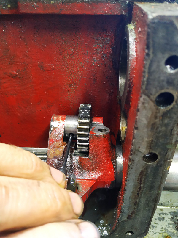

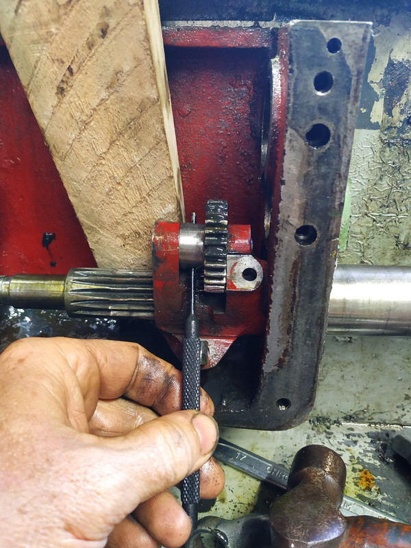

With some wisdom added to Brain, it seems like the small gear in the red shafty thingy is stuck on the shaft. So I knocked the shaft back a tiny bit and the gear could move. OK, time to remove you Mr Gear. No, not you Richard!
Thanks Mr Allen!  Ooops not so fast. That is a pin and not a grub screw! Let's tap you out Mr Pin.

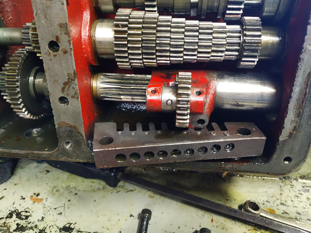

With the gear removed, the red shafty thingy was free to allow the shaft to slide. Or is that now the other way round? The shaft free to slide?
Yes, purple gloves and grease do not go together? So why does the Doc put one on when he uses Vaseline ...  :thinking:
And out came the red shafty thingy. You need to move it as far to the left as possible and it will swivel enough in the right hand bush to be pulled forward on the left end.

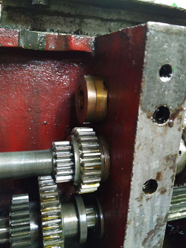

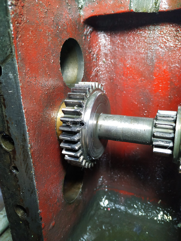

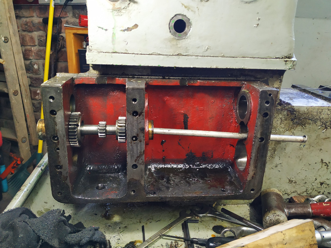

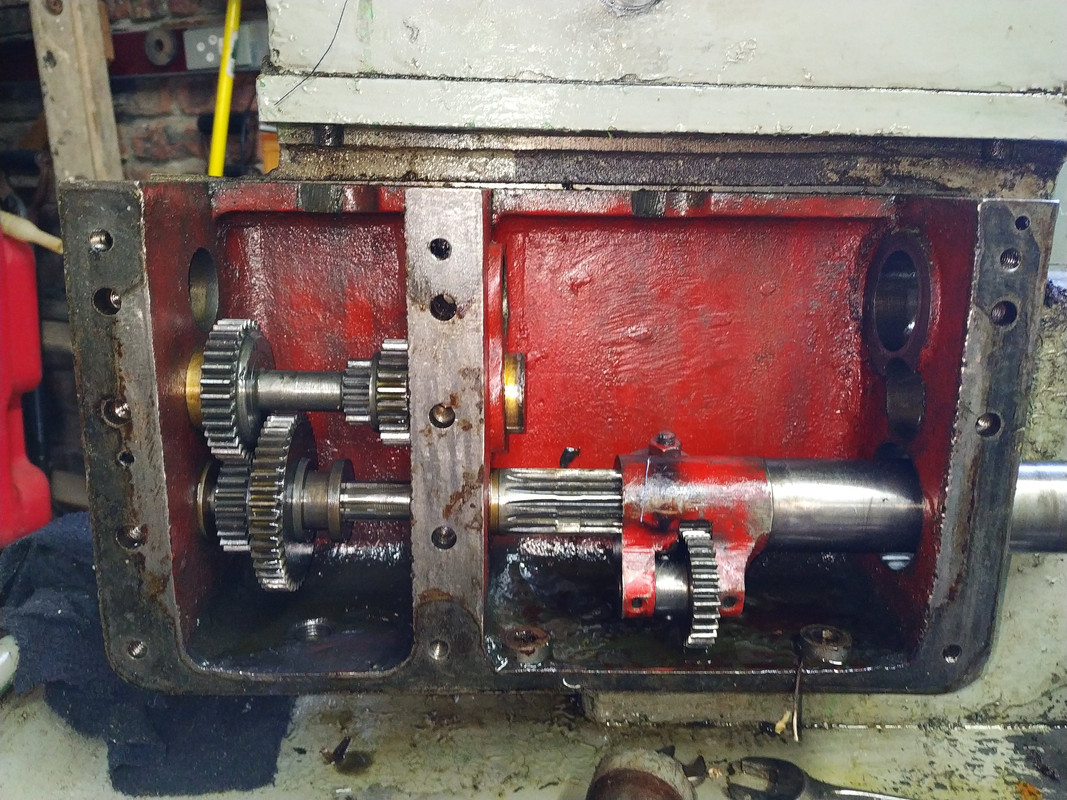

That left the left middle shaft.  This is called the intershaft with 14 teeth. What a weird name. :nutter:
Coffee time ...  :thumbs:  Ha, Brain was well energised and I spotted the gear's secret quickly. An angled grub screw in the gear's collar. Uncle Allen helped us out quickly.
 By now I was used to tapping shafts to shift bushes. Tap it to the left, tap it to the left ... sounds like a kid's song.  :giggle:
And suddenly the gearbox was void and empty and the smell of old oil was all that remains ...
 :cleansound:

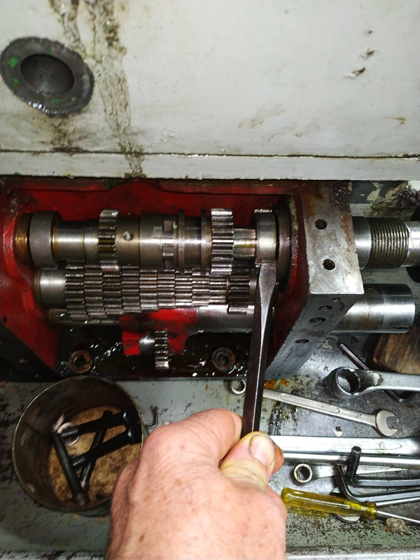

Onto attending to the two lonely gear shifting levers in the headstock. Carl has been cleaning and removing grease over a few days using a whole bale of rags and 3 liters of paraffin in the process. At long last we could see how to disassemble these. On this funny lathe, there is a nut on the underside of the vertical spindle that needs to be undone.
The spanner to use is a 13/16" AF and you will need a lot of patience to get the nut removed. There is not a lot of space to work with and you ideally need an offset spanner.  Remember that as the nut nears the end of the thread, you need to lift the handle assembly so that the nut is lifted away from the headstock bottom, allowing the spanner better turning room.
And there the headstock was ... void and empty and the smell of old oil, aaagh, I mean grease, was all that remains ...
Since I am now a wonder at removing bushes, I tackled the tailstock end support for the leadscrew and feedshaft.
Checking for grub screws that holds the bushes fast, I found nothing .... strange.  :thinking:
Check again Brain said. If it is too easy you have overlooked the obvious.  Murphey's Law #8 if I remember correctly. So what I thought earlier to be an empty hole in the support, in fact was hiding a grub screw.
Using my phone's camera, we spotted the bottom one as well! Took a bit of cleaning by feel, but we got the hole cleared for Uncle Allen's to do the removal.
A quick knock with the aluminium bar and there the rascals lay. Like two sweet little sleeping kids.
Just to make sure they behave Carl tied them up ... he was not taking any chances!  The grub screws went into the rag pocket to keep them company. Almost like a rag doll, come to think of it.
Finally .... There she stands. Stripped of all parts except the electrical motor. Time to reflect on what we have done!  :sweat:

In one of the pics I saw two screws and the spring that you'll have lying on your bench when it's reassembled. No, not going to tell you which ones.
To get out stuck capscrews, etc, not better to use an impact driver to provide more of a repeating impulse force than a hard twist? Impact driver, allan key socket.
Re: 1953 Colchester Student Mk1 6" gap bed - A restoration project
« Reply #56 on: May 27, 2020, 08:56:40 AM »
Nicely done.
Thanks for the comments!
Ai, now I need to go spring hunting ...
No way I could get an impact driver in there nor a key socket. The top of the toothy thing is below the shaft above it and also below the top of the gearbox. Impact was the way I wanted to do it. Secondly the cost of an imperial Allen key socket is something I had to consider as I had to go and find one in town. Rather break an Allen key of which I had two.
