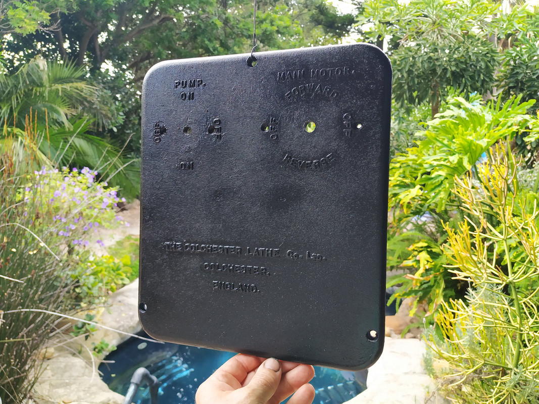

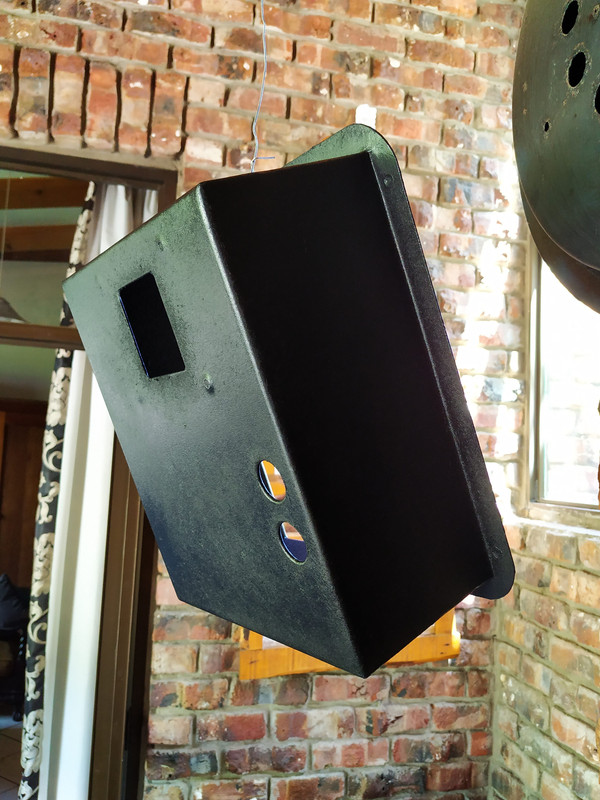

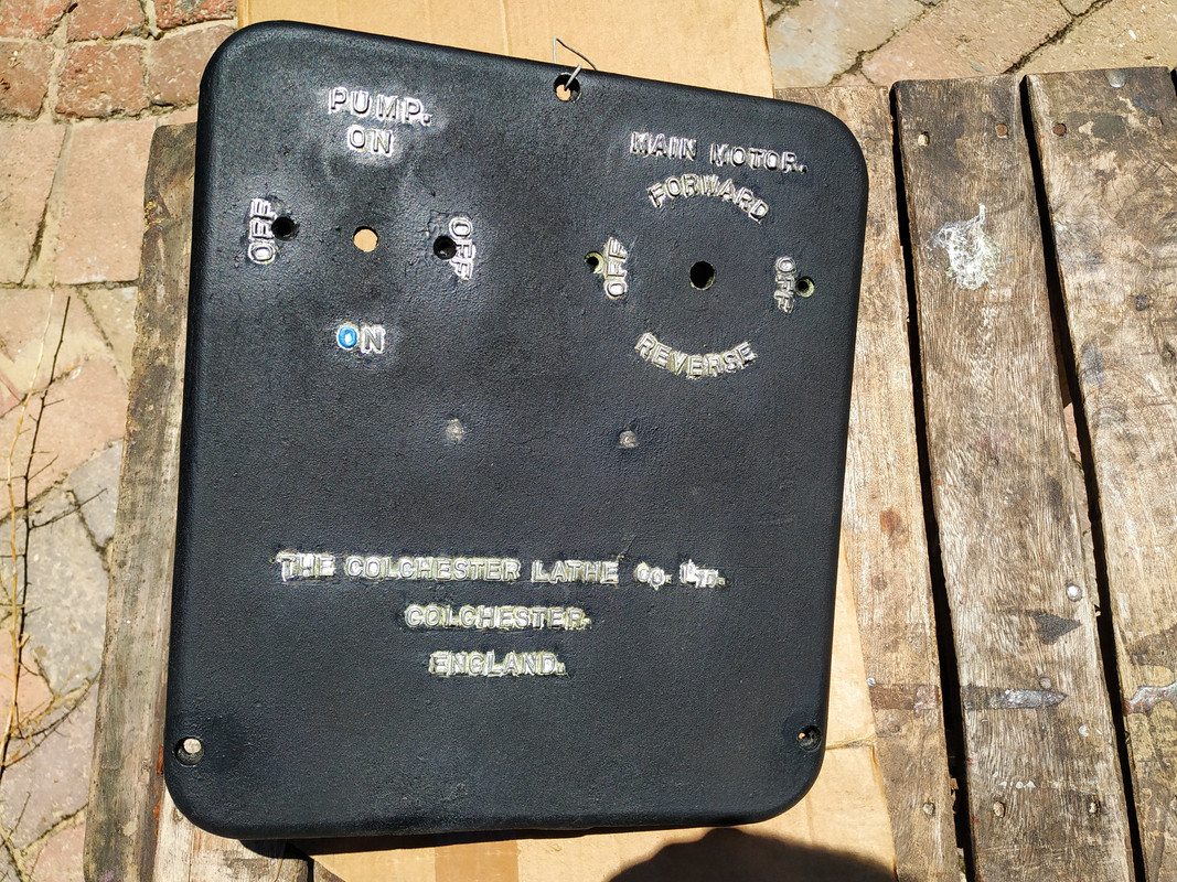

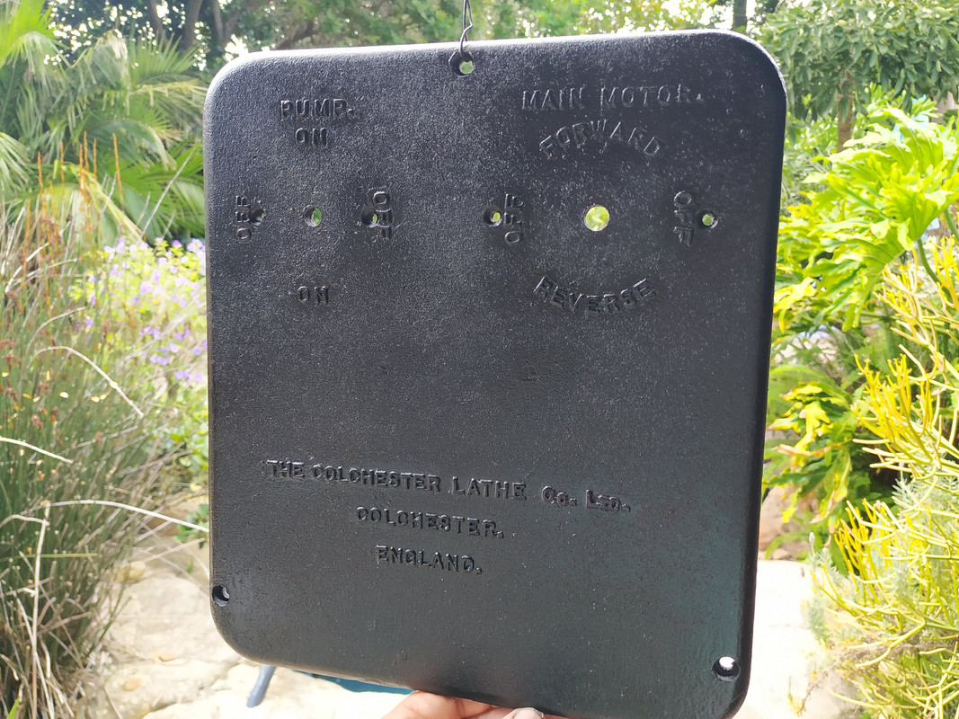

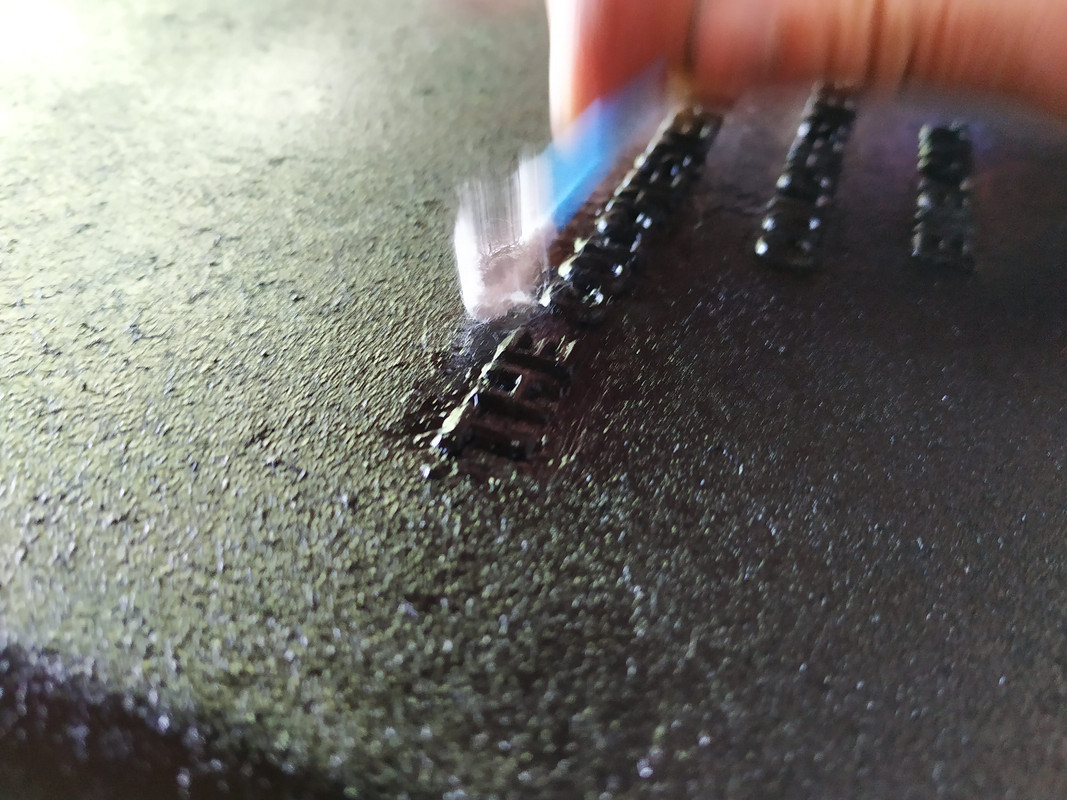

« Reply #312 on: December 20, 2020, 06:05:28 PM »

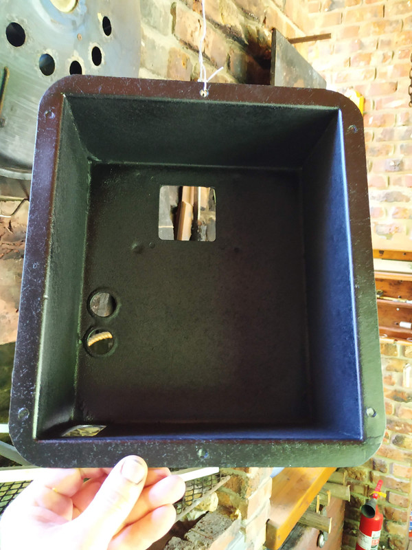

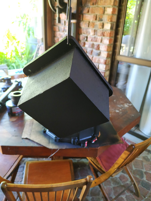

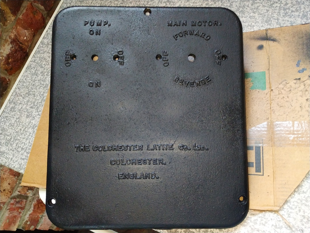

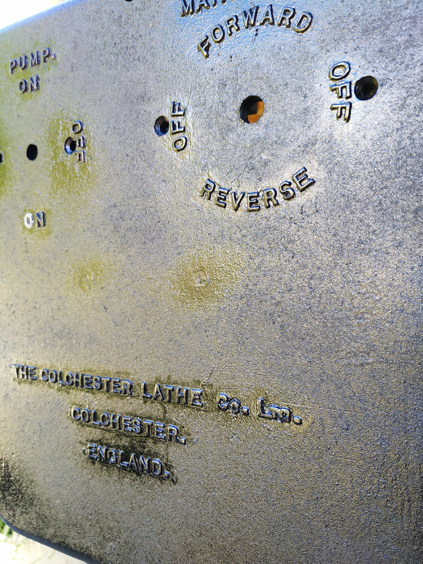

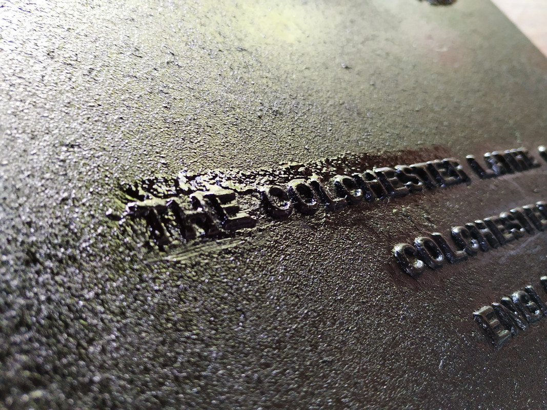

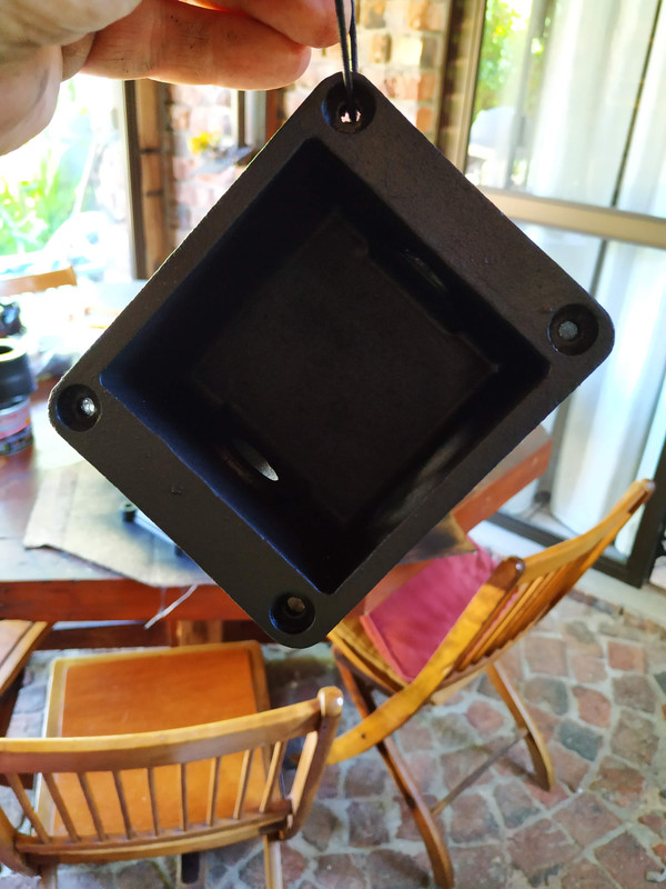

I finally had some time to work on the lathe again!  :dop:
The electrical enclosure and switch panel had to be sprayed and since I was spraying some Pajero parts, I added these to the parts to be coated.
The front panel as I left it a while ago. Cleaned with some lacquer thinners and ready for the lettering to be etched primed.
Etch primer and a later layer of 2K black sprayed on. I am not happy as the areas I cleaned before is now glossy whilst the greater area has the rough finish I sprayed on earlier.
I will have to sort this out somehow.
The little box thingamajig with the new final 2K black coating looking quite swanky. It just needs a tie and a companion in a red dress!
The back cover of the electrical panel also ready to go to the formal party in its new coat.
Next step was to spray some matt 2K clear coat on the electrical switch panel.
Before I did this, I tried my luck to get rid of the smooth areas by roughing the smooth glossy areas with some tacky 2K black paint and an earbud.
I left this to dry overnight and this morning sprayed the matt clear coat.  A lot better but still some glossy spots ...
Whilst spraying some Pajero parts I over sprayed the glossy areas with the etching primer again to get the same rough finish. Lots of air and minimal paint settings on the gun is the way to do it.
It looks much better now and I think I can put the final layer of black on tomorrow. I will simply roughen the glossy parts now with a foam sanding pad to break the gloss before applying the final black layer.
The photo actually gives a false image as the glossy sections are in fact the matt areas and vice versa. Wonder why it came out like this? Anyway ...
Have a good week!  :dop:
