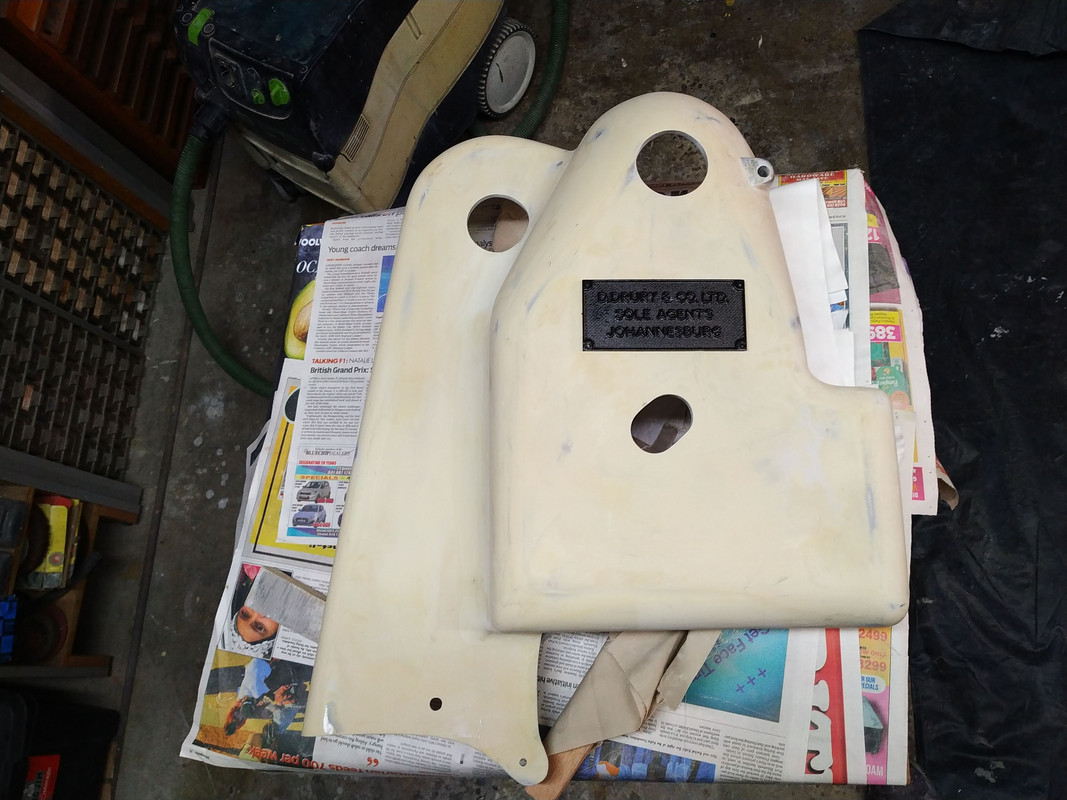

And there we FINALLY have a fully shaped and sanded lid. Side lid that is ... one that lids belts, pulleys and gears. A screwed down lid.  :angel:
Only thing left to do was to sand the one small area of touched up filler. Brain timed me and according to him it took 5,0541808184E-6 Marsian years. So it was fairly quick!
Then it was onto the hole riddle nobody could solve. So nobody won a prize!  :sd:
And the answer is .... tada ...

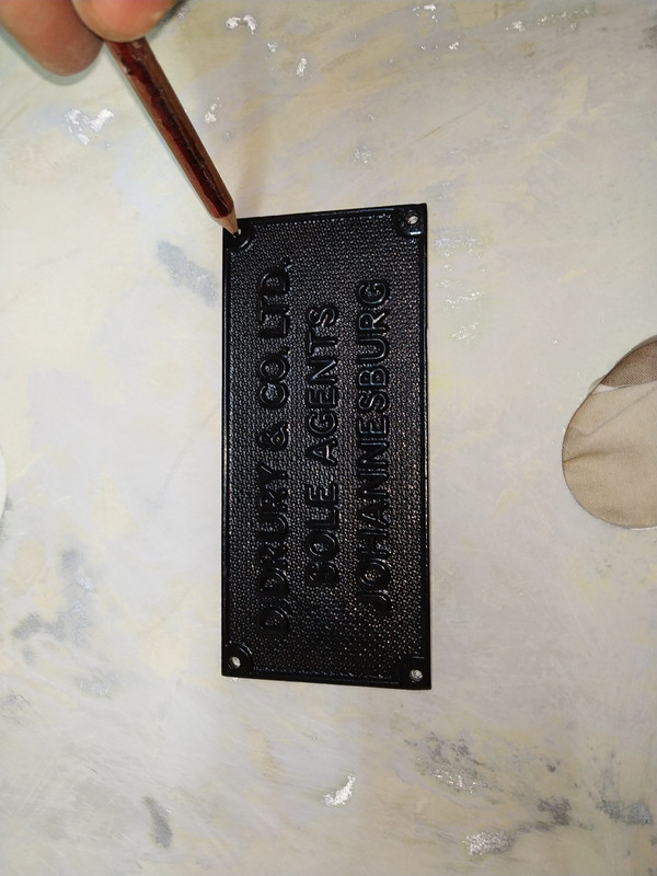

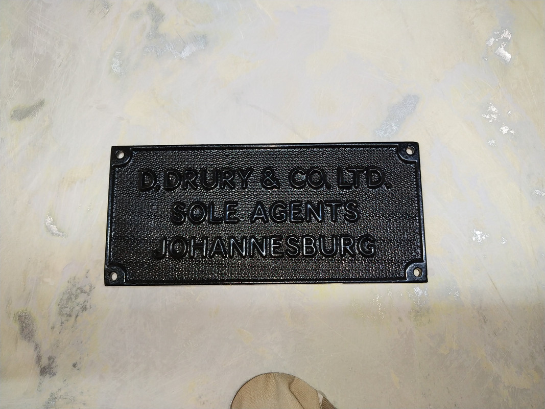

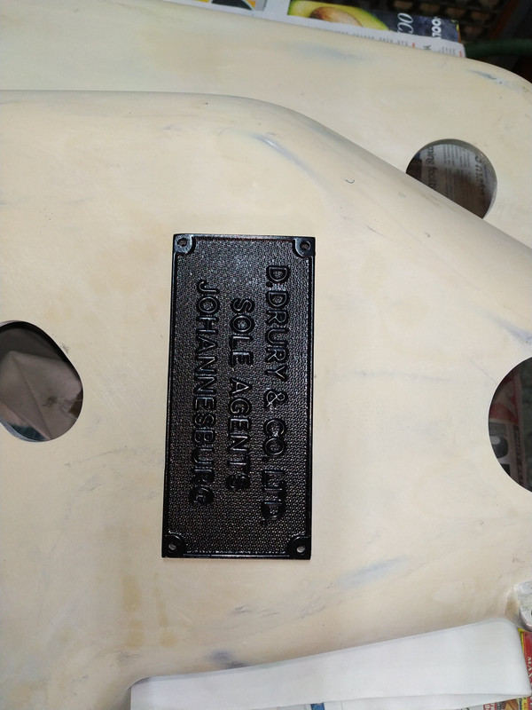

The brass plaque had to be mounted  :rubhands:

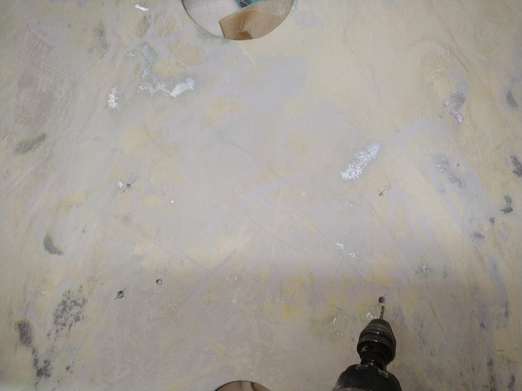

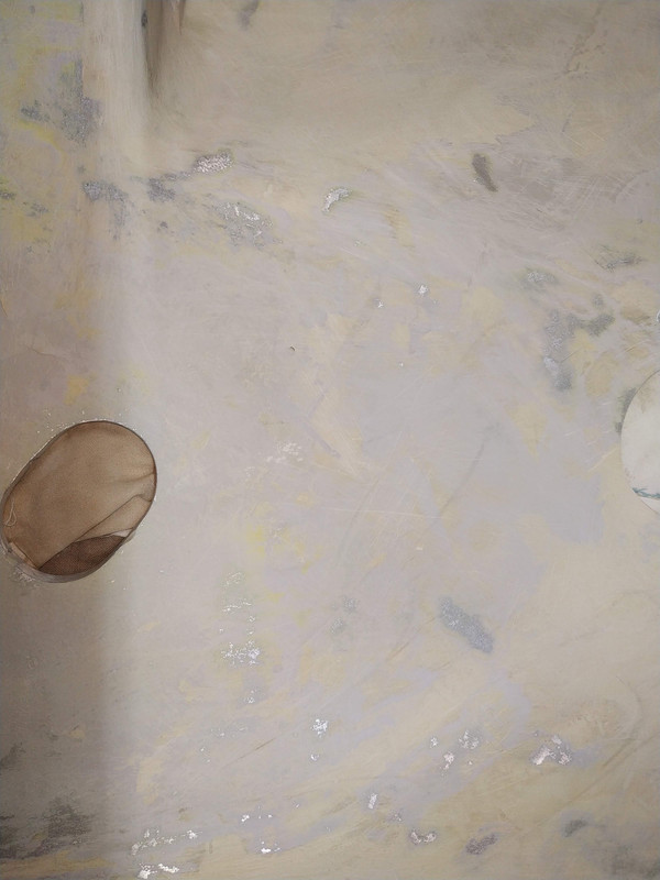

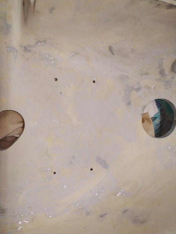

From the back of the cover I can still see all the holes that was filled with filler.
So many choices, so many combinations. Oh what to do! "Calm down" said Brain. "Go and fetch the blessed plaque and measure it out".
What a good idea!

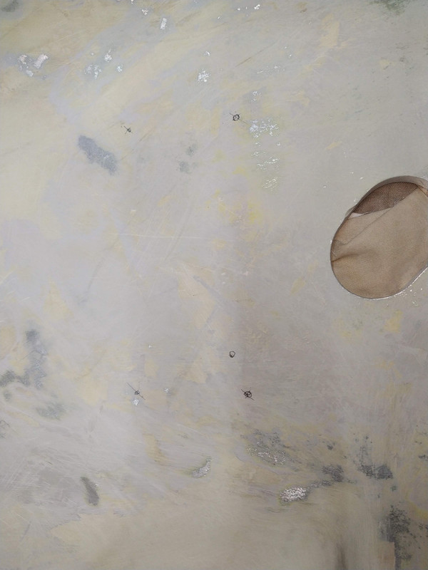

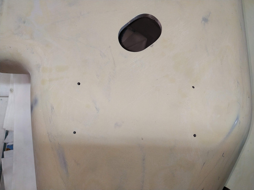

Found the 1/28 holes! Time to mark these out.
In the meantime Carl was sanding the third layer of filler on the flanks of the beast. This time with 150 grit.
For me, it was onto playing dentist again ...
And there we are.
Cleaned on the outside face as well. Looking good.  :thumbs:

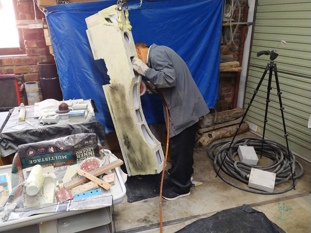

An hour later and the beast's flankes were done to 320 grit. That went quick. Onto leveling the bottom and applying a final layer of filler.
While Carl was doing the 320 grit exercise, I sanded the traveler in our family.

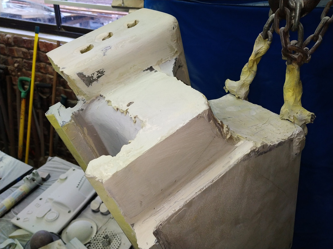

Then I tackled the beast's belly and shaped the sides corners.
Took another hour and there we are. Smoothed to 180 grit.
Then it was time for my silky touch ...  smooth as 320 grit.

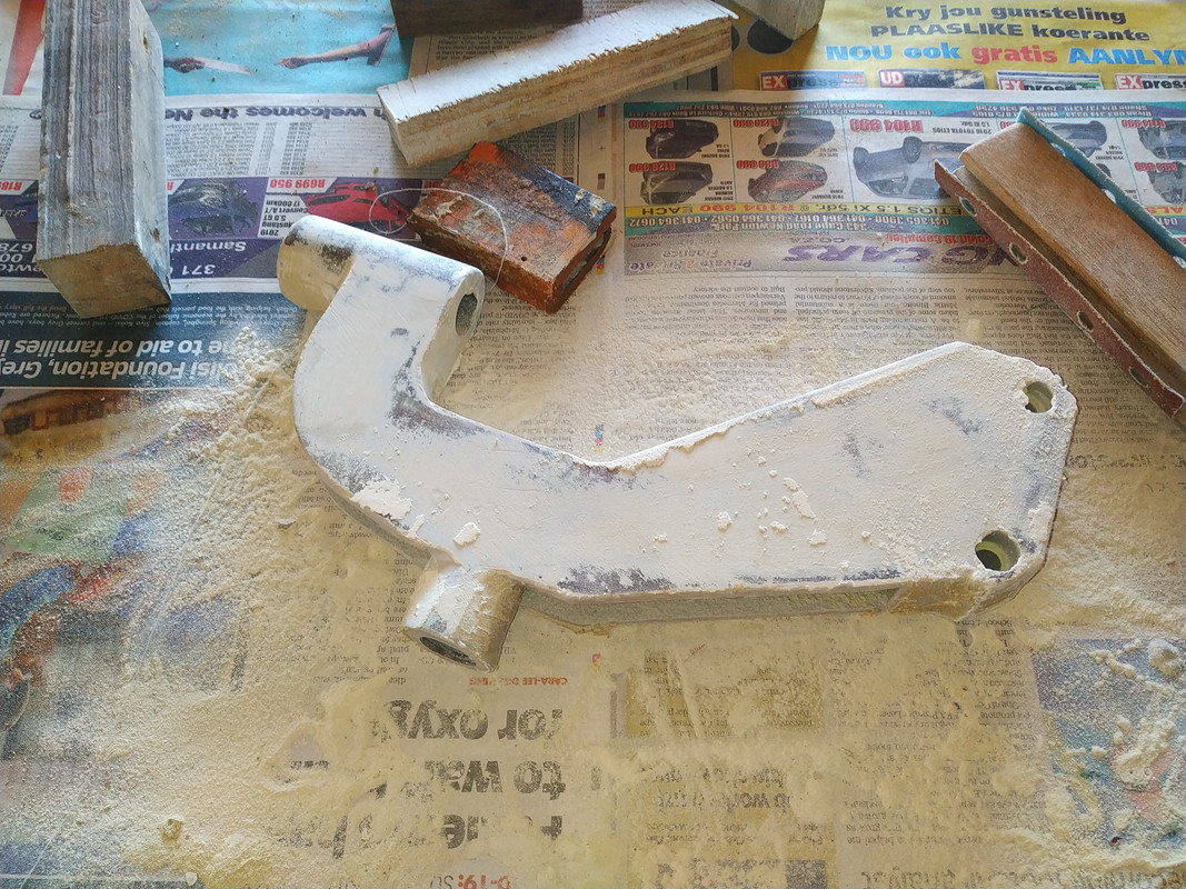

This morning was spent sanding the traveling member. Here we are to 180 grit.
Then it was time to get to foot's raised edge neat and tidy. All in the name of CDO.  :goofy:
I like playing dentist dentist so out came the dremel tool again ...
And there we are. A neat inner edge.
Cleaned up with a cone stone.
All sanded to 220 grit.
Now onto cleaning all the holes of filler. First bit of progress ...
And some more ...
There we are. I will ream these holes after the final coat was applied.
I then progressed to sanding the traveler to 320 grit. The last little bit of work was to patch two small dings with filler.

I needed the wood working vice so I decided to finish our world traveler.
Touch up areas all sanded to 320 grit.
Do you see what I see? I forgot to clean the cap screw countersunk holes!
Time to play dentist dentist again  :Whoohoo:
Hmmm, the holes are cleared of filler, but I will have to spray the insides of these holes. Some more cleaning was therefore required. Using a cylindrical stone I lightly grinded the inside surface of each hole.
And there we are ... all done with the traveller.

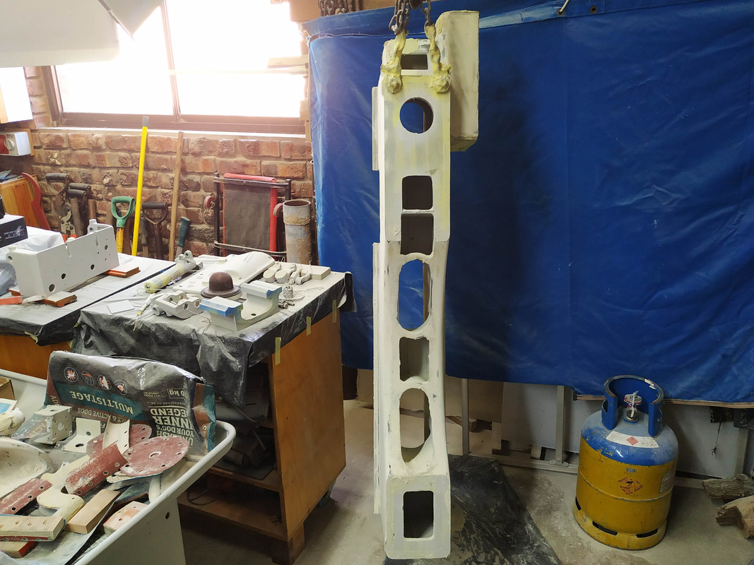

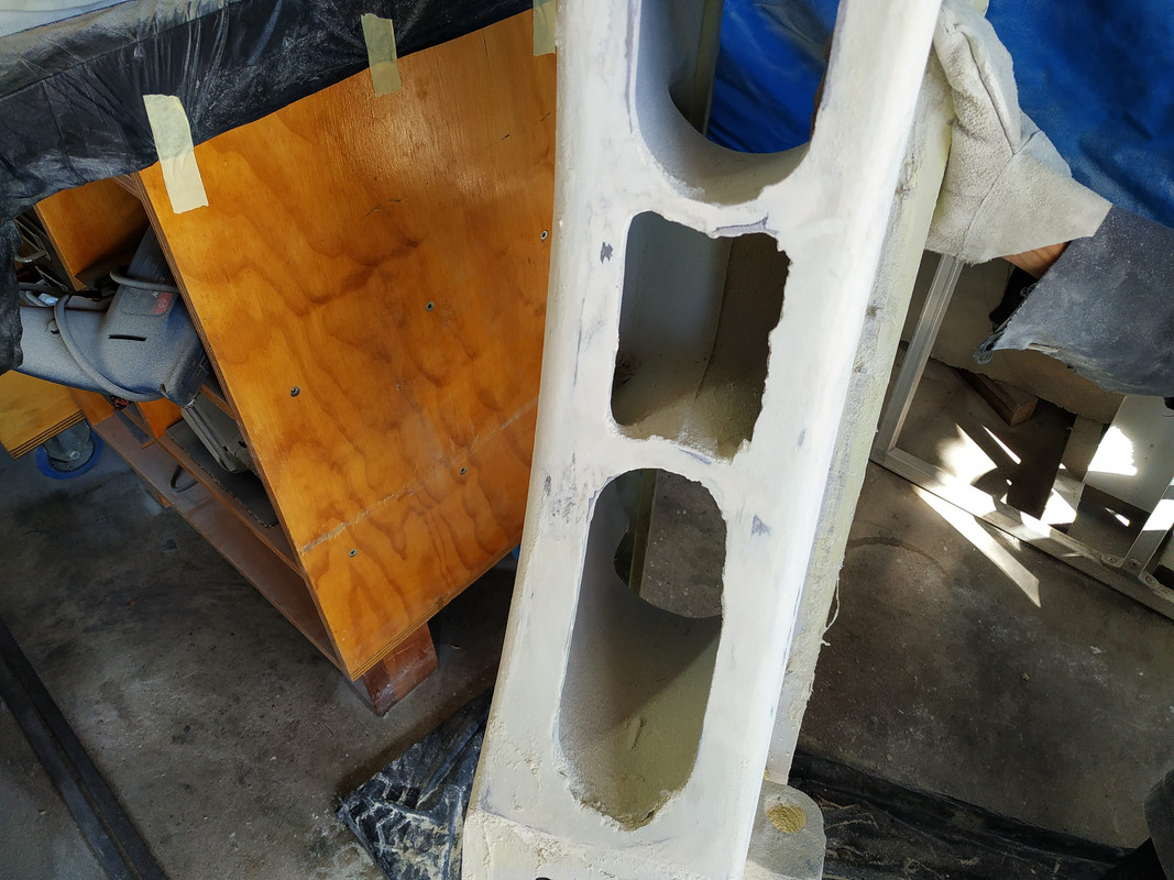

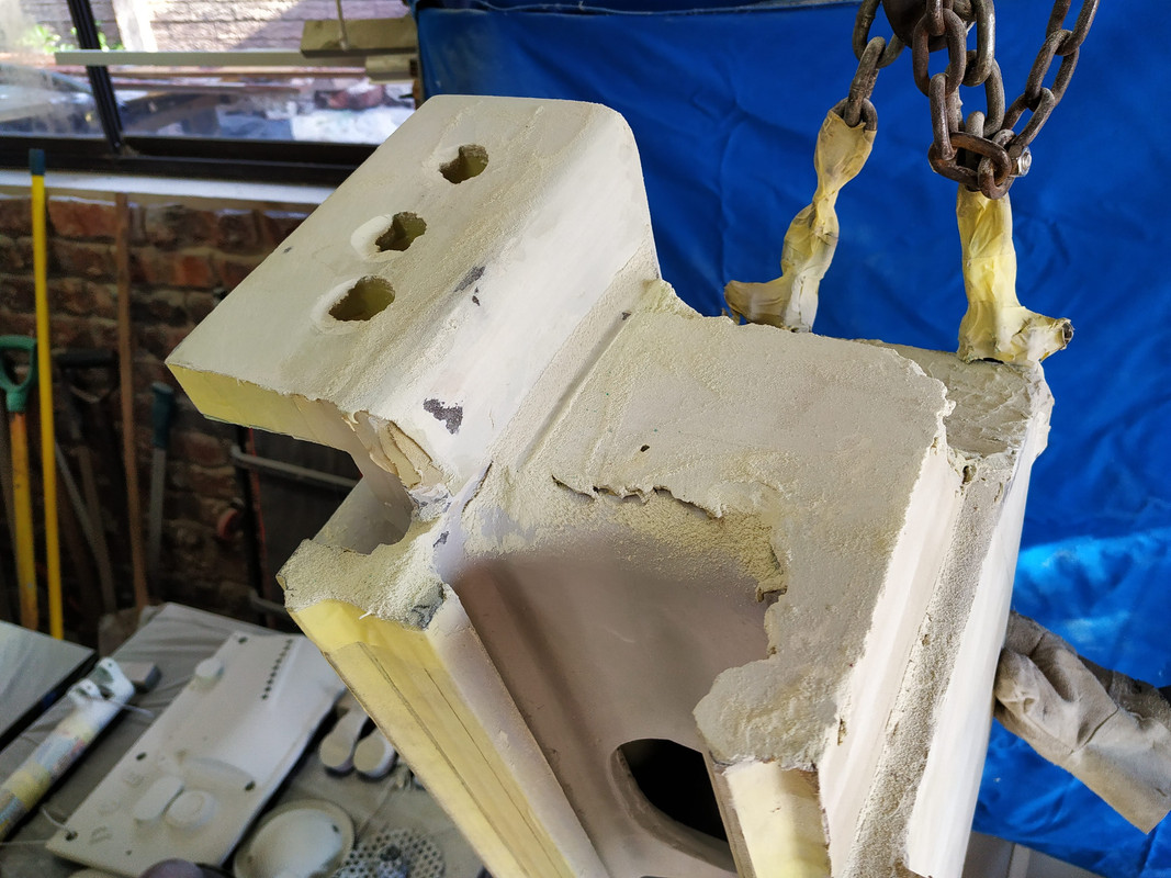

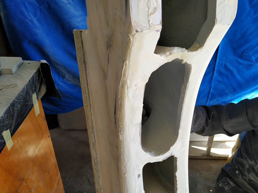

Another day of sanding ...
Not much to report except that it was another day of sanding ...
Carl started off with the stand and finishing up to the 220 grit stage.
I tackled the gearbox cover and worked on all the nooks and crannies. A huge amount of time this one is requiring.  :sweat:
By the afternoon Carl was finished with the stand to 320 grit. He proceeded to vacuum all the dust from it and then wiped it down with a thinners cloth. All ready for spraying. Just as I was gathering the spray gun and MS Primer, the wind starting blowing with a massive gust ... spraying plans all blown for a loop. Hopefully tomorrow will be better weather.  :pray:
With no spraying to do, Carl started sanding the coolant chamber's door as well as all the lamp's parts and many of the small parts. I worked on the cover and finished all the detail.
Next was some touch up body filler on the imperfections and curves of the cover's new surface. While Carl was cleaning the garage I started sanding the new filler to match the existing surface. There we are, the cover is almost done.  :2thumbs:

I had to find the plaque's mounting holes again and clear these of filler. First step was to fit the plaque.
Then marking out the location of the holes, it was.
All the holes cleared of filler and the lid completed to 320 grit.
By this time Carl has finished the door to 220 grit and it was time to smooth out the indentions with some filler.
While Carl was waiting for the filler to cure, he tackled the drawer. Me? I tackled the top lid. Can you spot the progress?
The small detailed curves drove me almost insane. Maybe an Italian designed this lid??
The drawer sanded to 220 grit and the front leveled out with some filler. I will sand this tomorrow to a smooth surface.
And there we are! The topmost lid all done and finished to 320 grit.
And Murphuy had to have the last say ... oil in the cast iron made a section of filler release!  :facepalm:
Oh well, rather now than when the final top coat has been applied!
Carl had some time to sand the motor mounting plate. This done, he asked that I fill a very uneven spot.
While Carl was playing around with motor mounting plates, I smeared some filler on the front of the stand. The back is all nice and smooth while the front has a gazillion small dings. I wonder why??
And there we are ... all done for the day. Tomorrow I need to attend another site meeting, so it there will be no lathe work done in the morning.
The door and drawer patiently waiting on their turn to be sanded tomorrow.  :coffee:
