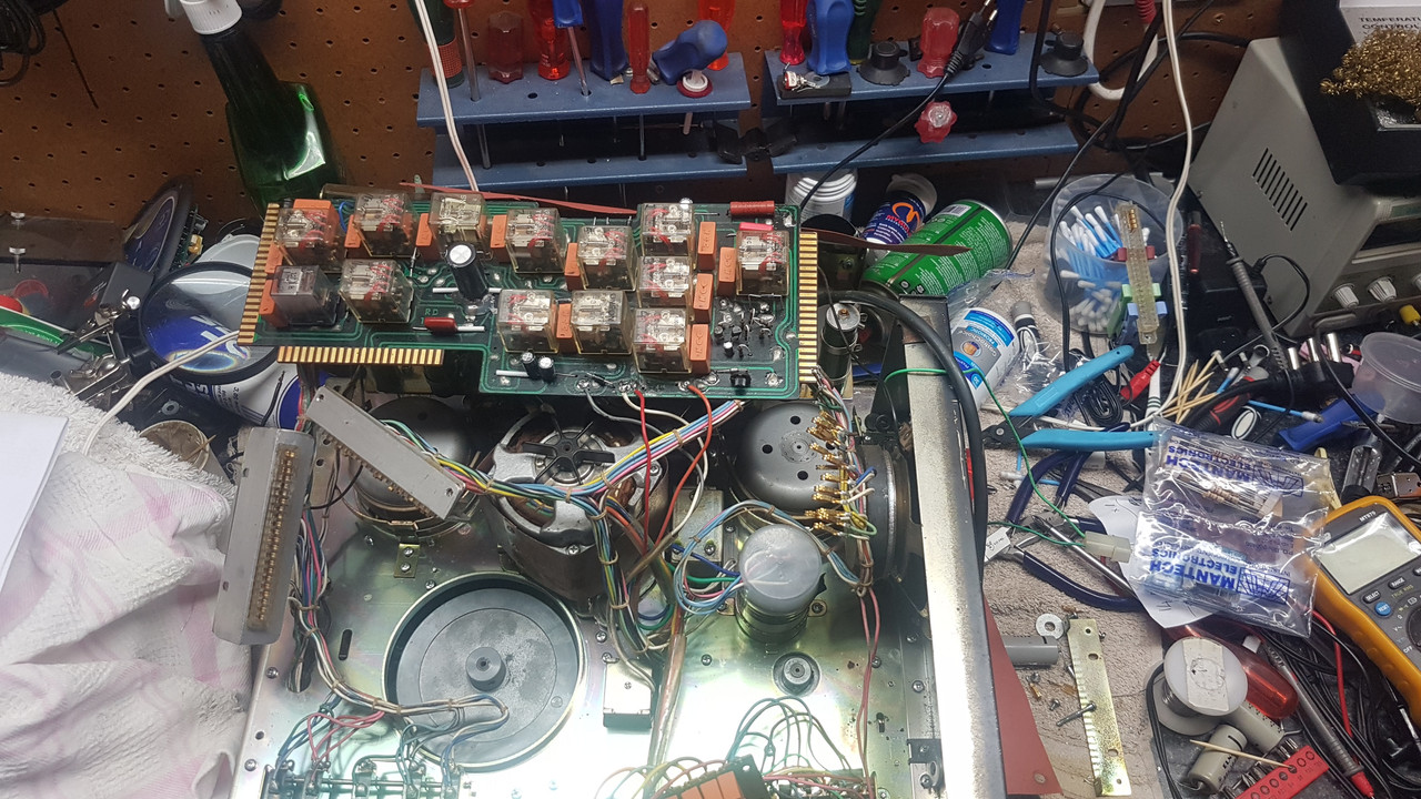

Back on the Akai again.  Replacing the 20 x snubber components.  Mantech said they can get, but never came back with price or availibility.
The relay board and the control board contains 20 in total. 120 ohm 1W resistor in series with 0.1uF poly cap 400v.  I will grab a pic shortly and share.
Offline Tbot
Re: What is on the bench today
« Reply #33 on: October 16, 2020, 12:00:37 PM »
This is the control board.  Pic is not great, but the orange squares left middle are swollen and cracked.
