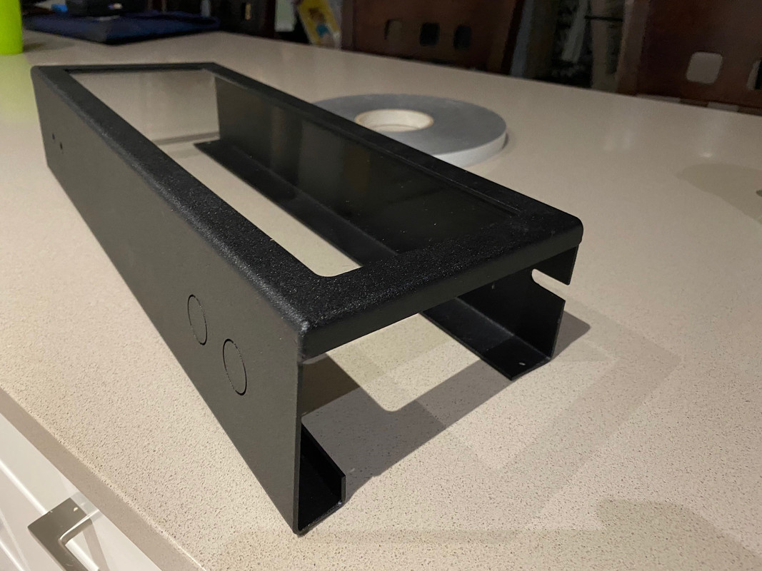

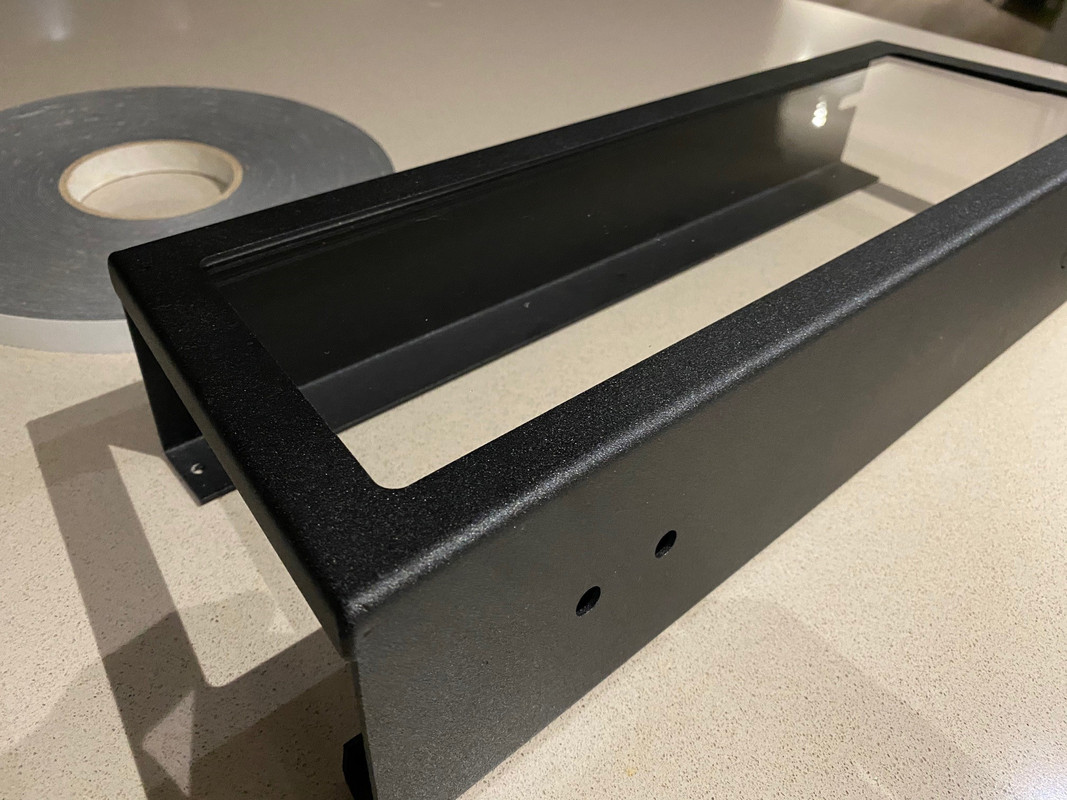

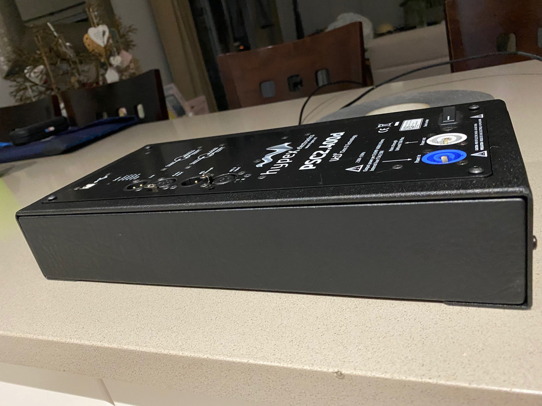

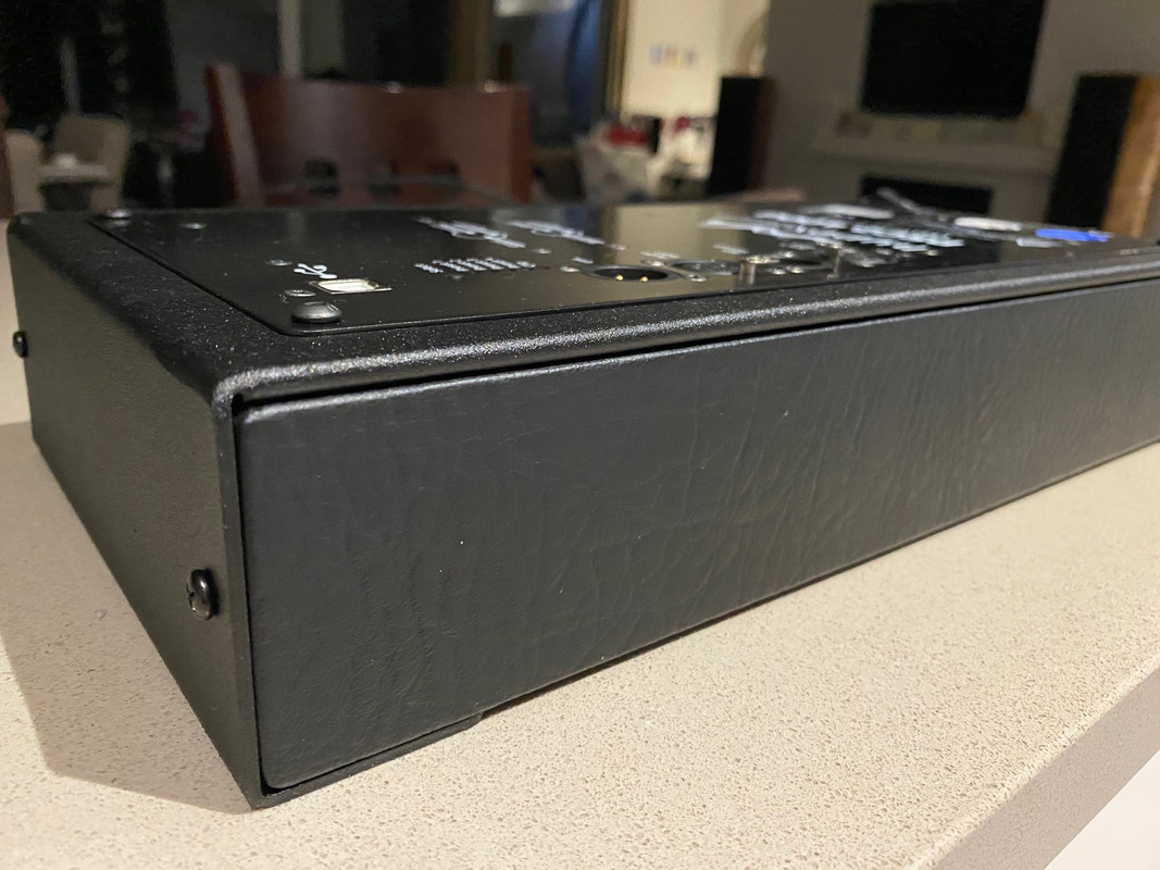

« Reply #72 on: February 05, 2020, 08:07:03 AM »
Morning all,
Just a little progress update on the steel enclosures.
Just 2mm bent up steel with hemmed sides (overlapping to underneath) to flush mount the plate amp and material covered MDF sides. Powder coated to same finish as OB frame.
Used Richard's amazing double sided tape to secure some 6mm Perspex to the underneath side of the top
Just waiting on some insulators then can mount the cross-over inside.
Must admit, this has been so much fun!
