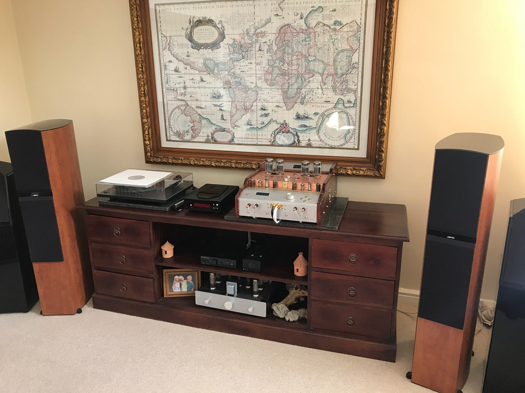

P.S. What's that valve amp on the bottom shelf? Another DIY amp? Maybe that's the AudioNitwit;)
Whilst Nidri takes reasonable care to ensure that the information in this message is correct and up to date, this might not always be the case. Nidri does not give any warranties as to the accuracy and safety of any information appearing in this message.
Offline Ufudu
Re: Audi-O-Moron 40W amplifier
« Reply #21 on: May 12, 2019, 05:43:49 PM »
No, not quite! That's one of Karel Mar's kits (slightly modified)
