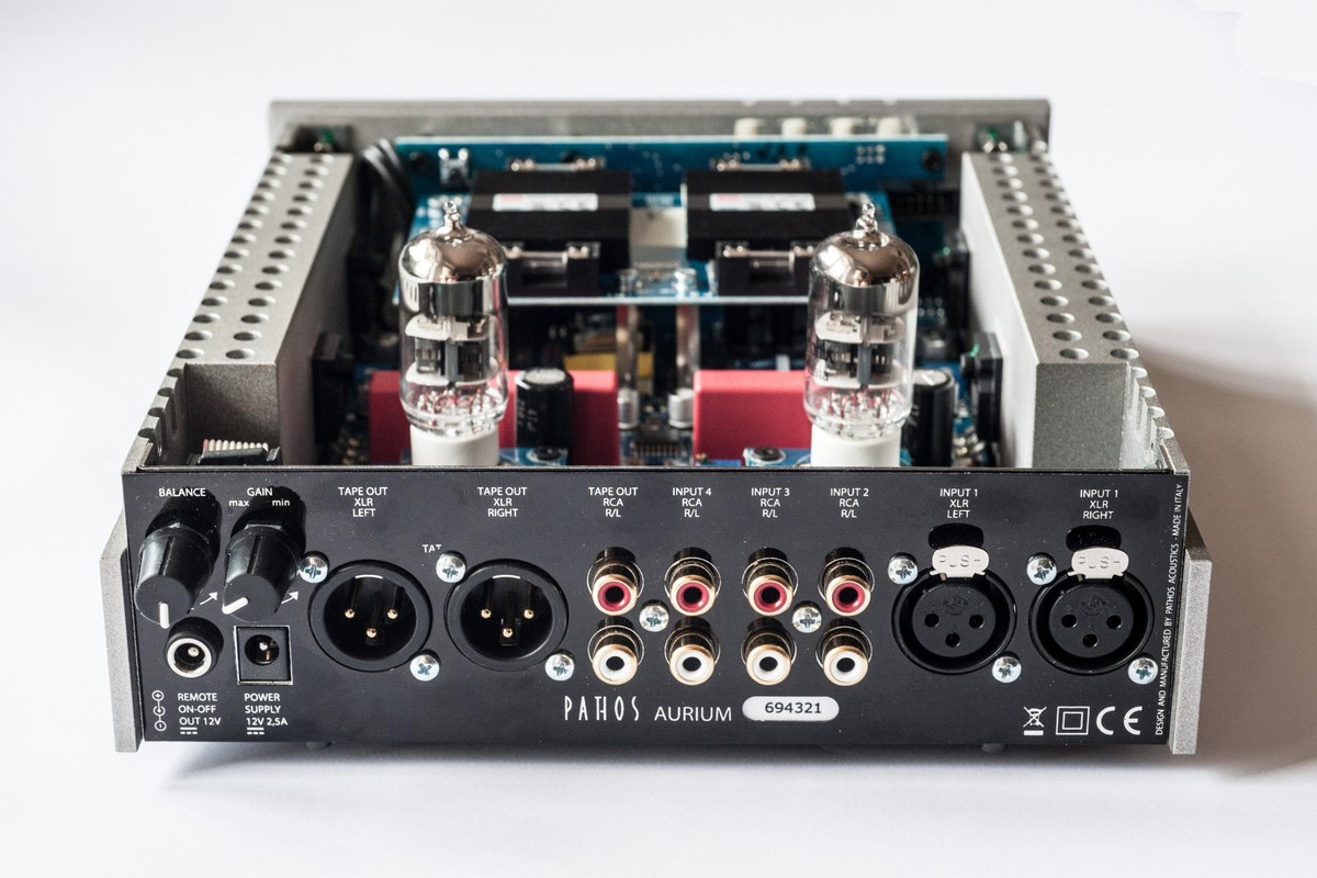

A sparse front panel with no labelling and that lovely volume pot is at odds with a very busy rear panel indeed.
Sporting 4 analog inputs (1 stereo balanced XLR, 3 stereo unbalanced RCA) and 2 analog outputs (1 L/R XLR and 1 L/R RCA) quaintly labeled "TAPE", there's a lot going on.
A 12VDC input, a 12V trigger and two very useful knobs complete the picture.
One of these knobs controls a 6dB gain and the other is a balance pot.
Whilst I can live without the balance functionality, to be able to adjust gain linearly in this manner is rather useful.
With both my LCD2F and HD600 I needed to set the gain on full.
