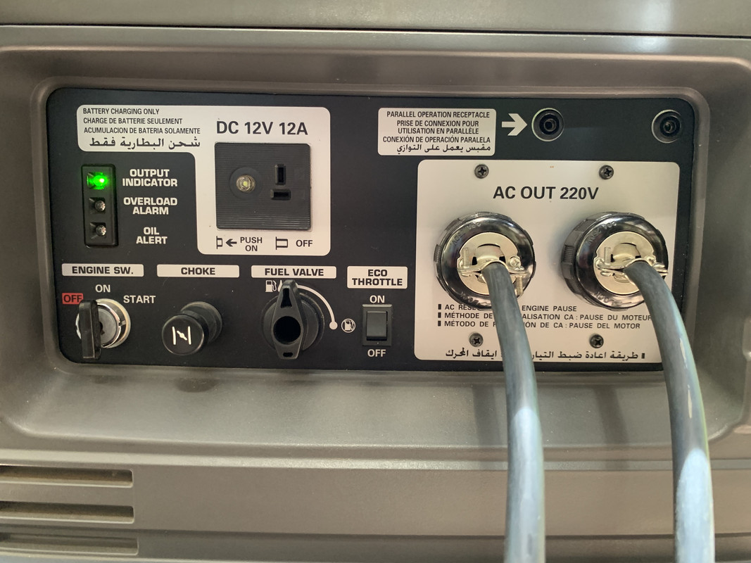

I had a look at inverter generators, apparently they are much quieter than the normal kind. Seeing as the cost for a good inverter/charger/battery was just over 10k, maybe a gennie might be a better option.
Does anyone have experience with these? I'm thinking of chatting to my neighbours and seeing if they're willing to go 50/50 on purchase and running cost.
I own and run a Honda eu3000is. Yes, it is silent enough to run in a townhouse complex. It has an eco switch, which allows the inverter to control the throttle, so the motor runs and consumes fuel in relation to demand.
It’ll run for 20 hours on 13lt of fuel, running my lights, fridge, freezer, tv, and the kettle and microwave, intermittently. All at pure sine 220volt. It is a fantastic piece of kit.
I rent, so I haven’t connected it to the db. I run 2.5 cabtyre all over the house, from the gennie.
But seriously, if you want to share with your neighbors, you’ll want to look at the eu6500is or the newer 7000. The eu3000 has 2800 watt capacity. If you connect two kettles, it’ll stall. You really have to have a decent relationship with your neighbors if it’s going to work.
Another great feature of the Honda inverter gennies is that you can daisy chain them. They have high level outputs that take a special cable, so you can connect them in parallel.
It’ll run for 20 hours on 13lt of fuel, running my lights, fridge, freezer, tv, and the kettle and microwave, intermittently. It is a fantastic piece of kit.
But seriously, if you want to share with your neighbors, you’ll want to look at the eu6500is or the newer 7000. The eu3000 has 2800 watt short term capacity. If you connect two kettles, it’ll stall. You really have to have a decent relationship with your neighbors if it’s going to work.

You can go for the eu1000 or 2000. Both can again be daisy chained if you need more power in future.
I bought it at a Honda Power dealer, a couple years back, 2015/2016. The eu1000/2000 are fairly available, usually. I think you might have trouble finding one now. The eu3000 and 7000 are scarce, usually, so I doubt you’ll find one now.
Kipor and Yamaha make similar inverter gennies.
