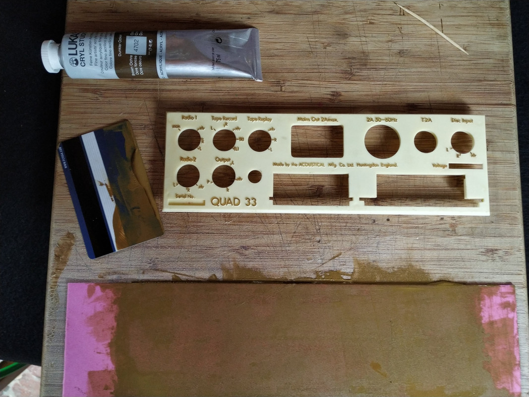

I had 30 minutes this afternoon to spend on getting the back plate's raised lettering covered in mud coloured acrylic paint. If you remember, I first try to do this with a roller and the roller itself ended up being concave and useless. Then @peterc gave me the idea of reversing the process and using the back plate as a rubber stamp to be coated.

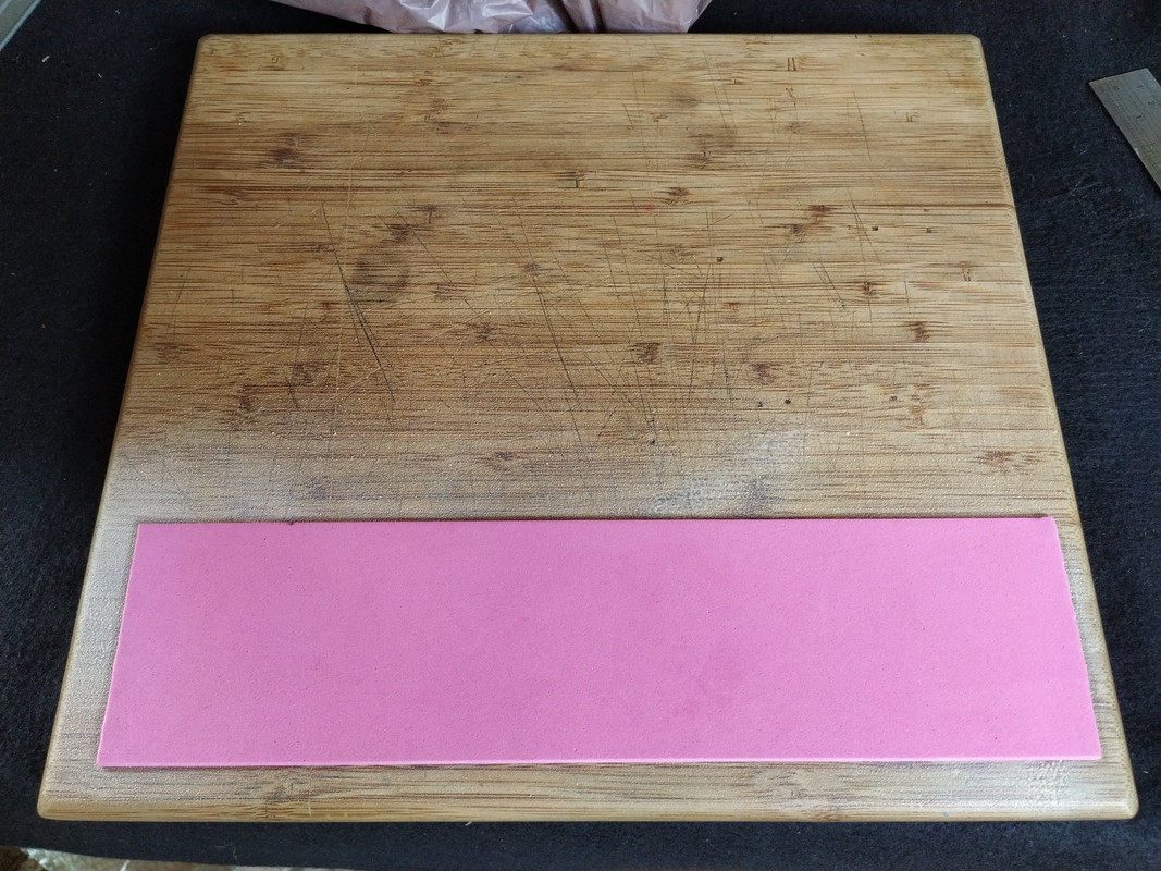

So about two weeks ago I bought some high density foam at the art shop, pinkish purple of colour to get the delicate feminine touch I need for this operation. ;-)
I cut a portion of the sheet, and stuck it to a cutting board (which I fished from the ocean when sailing) using my favourite temporary glue, 3M Spray Mount.

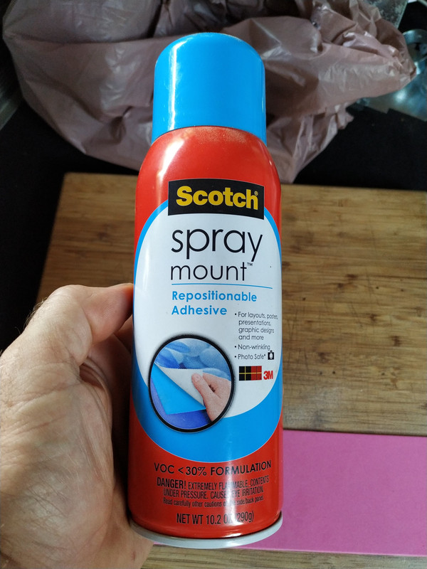

Spray mount really grips but you can peel the glued items apart very easily and clean the glue off with a water soaked rag. A picture to show you what it looks when you want to buy it at your local art supplier.

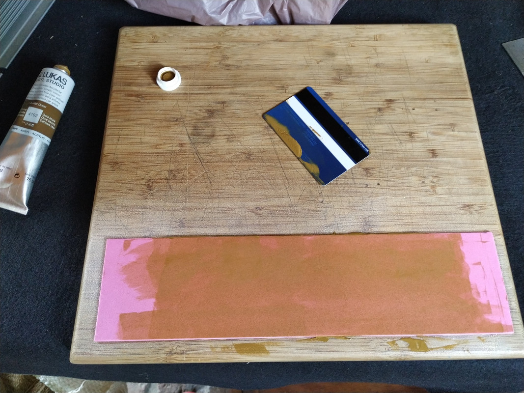

I then spread some acrylic paint on the foam with my new SAA voyager miles card. At least the card is good for something .... I followed @peterc 's advice and kept the coating thin and even.

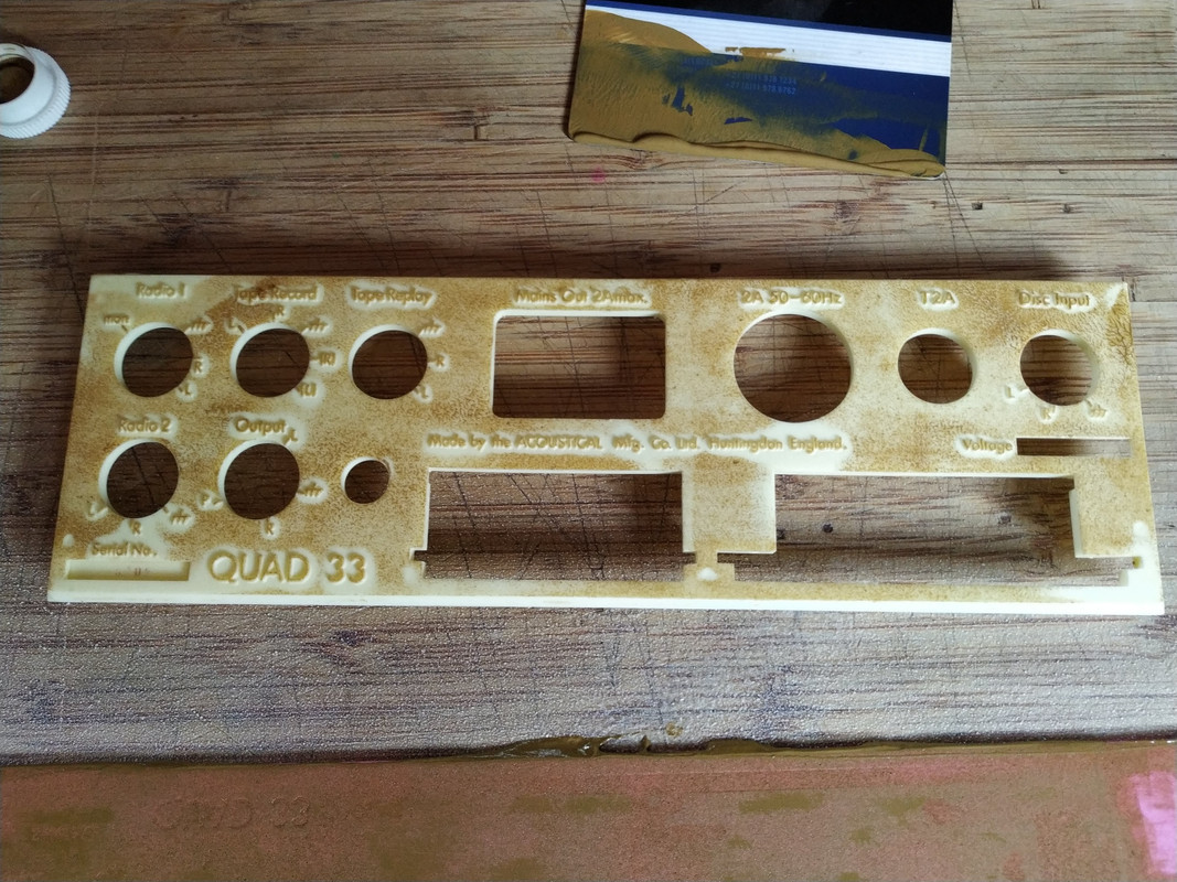

Alas, the coating was too thin and the lettering did not cover well.
So I tried again with a bit more paint and pressing a bit harder. Not a good idea as I now covered the entire back plate's surface with paint! Oh well, that is the way we learn.
A quick wash with water and an even thin coating of paint on the foam later I found that a light press of the back plate onto the foam gets an even although very light inking on the lettering. So I touched it again to the foamed ink and by the fourth round it looked perfect!
Thanks @peterc for the advice! Job well done!
