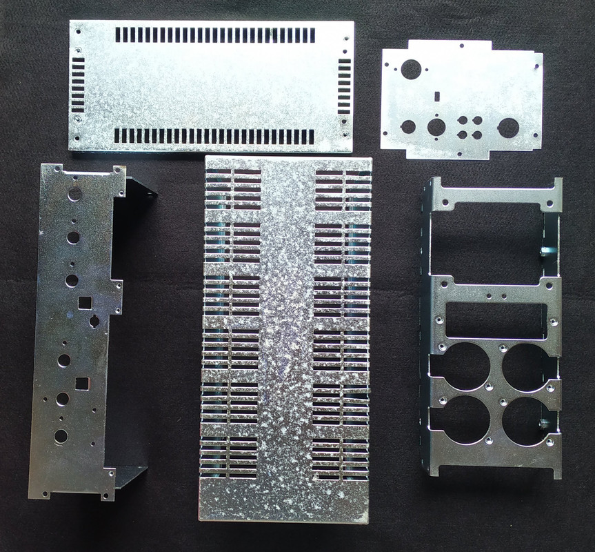

Dang ... the 303 chassis has also corroded, so I had to strip everything I have assembled from it. It will go back to the platers as well. Dunno what the heck they did but the coating IMHO is way too thin to offer any protection.
Re: Quad 303 restoration

I handed the parts in this morning and got an email this afternoon to please come and collect. Let's trust that this time round it will be done so that no rust will appear!

Anyway I spent the time in town, making my water purification skid's shopping list a bit shorter and collecting the replated Quad 303 and 33 parts. Looking good this time round.

Just to be double sure I am not running into an oxidation issue again I dunked the 303 and 33 chassis into @Family_Dog's SAF-DEM dupa.
I am hoping this will seal it just that little tiny extra bit required.
All nicely dried and ready for assembly. The rest of the parts I will coat with a layer of primer to make sure that those are seals as well.

Out of interest what did you plate with? I did MGA manifold in nickel and it a) looks great and b) will outlast the car.
Normal bright zinc plating.

I have to admit that I was thinking I would be asked that. It was some time ago, via a friend. I understand them (remains beyond my brain cells to recall the exact name) to have gone belly up subsequent. It was a matt finish, but specifically done to handle high heat. It probably hinders you more than helps you I'm afraid, but I would have thought nickel would have been pretty good as a material for longevity and corrosion prevention?
