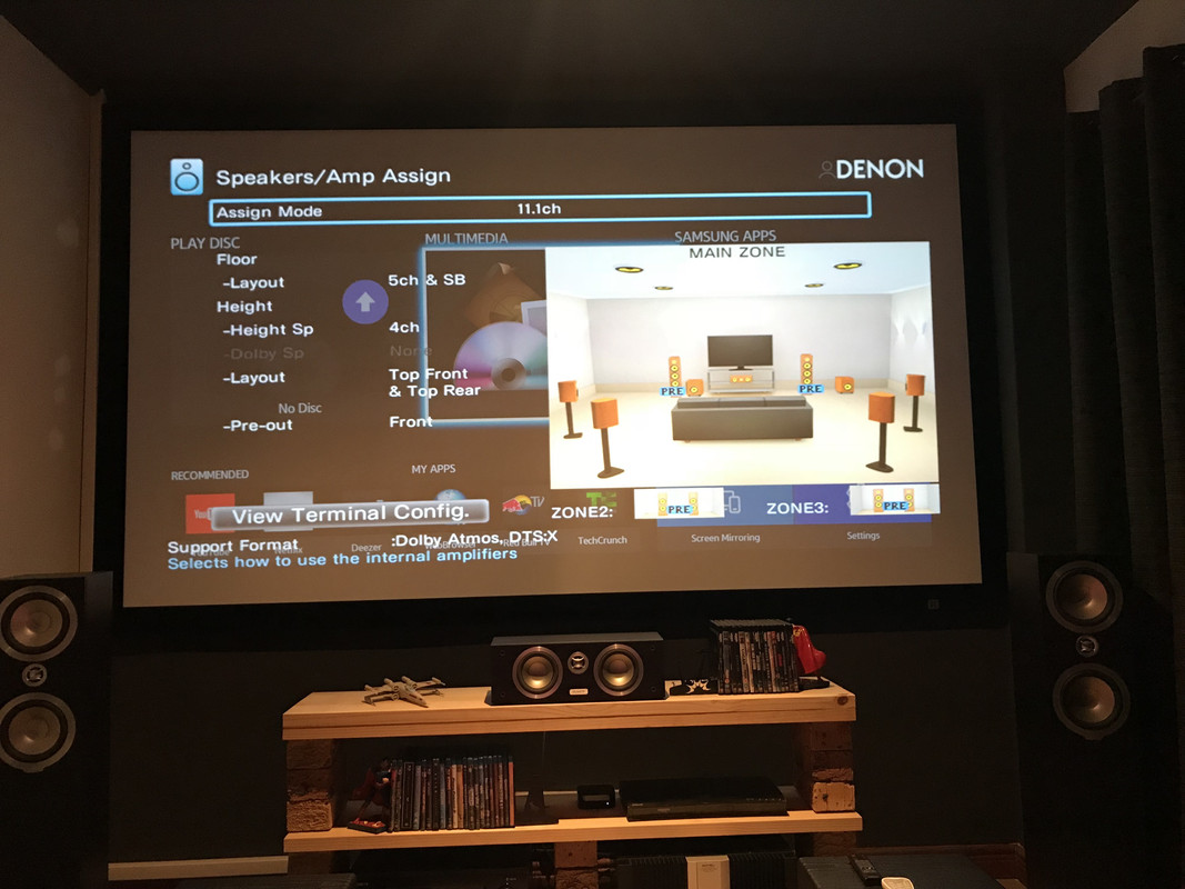

« Reply #7 on: September 05, 2018, 09:28:53 PM »
Here is mine. Remember I have the 4300. It only has amps for 9 channels. As I do 11 channels for 7.2.4, the 2 front speakers must get power from an external power amp.
On your 6300 you have 11 onboard amps. If you do only 5.2.4 you only need 9 channels to operate. You need to set your amp assign to 9.1 channels. The pre-outs are always in operation. You then connect the front speakers (left and right) pre-outs to an external power amp. Your front speakers are then hooked up the power amp. IMPORTANT, the speaker cable for the front speakers go the power amp NOT the AVR.
You need to get rid of the "9.1 channel + front B". The front B is the issue. It is used if you have a second set of front speakers. Yours must only say "9.1 channel + zone 2". You will not need zone 2 but internally in the 6300 the spare 2 amps of the available 11 amps have been assigned to zone 2.

Good news!
this has solved the problem. there seem to be a few other options like 9.1 plus zone2/zone 3 and zone 3 only - will give them a try but your option above works great
