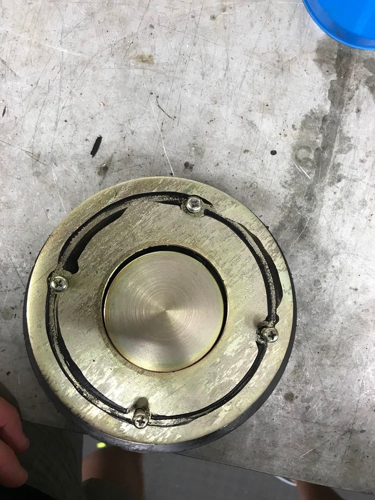

So my vintage 690's are frozen! I am deeply saddened by this as I love these speakers.
My old faithfuls have suffered what appears to be a common problem of shifted magnets. I've taken the one apart - no way of removing the magnet without destroying the cone. There is evidence of rust on the glued surfaces and the pole piece has broken loose and stuck to the ring magnet.
What to do? Is this assembly repairable? I'm thinking along the lines of making a jig to assist with alignment and re-gluing the magnets back together. Then I will need to purchase new cones and have the woofers re-built.

It will require some careful mechanical jigging but, yes, that can be restored. They usually only magnetise those parts after assembly.
Sounded like you had a plan. I would try to preserve the cone if possible. Once you glue the motor parts back together, send everything to Merle so she can replace like for like as far as possible.
