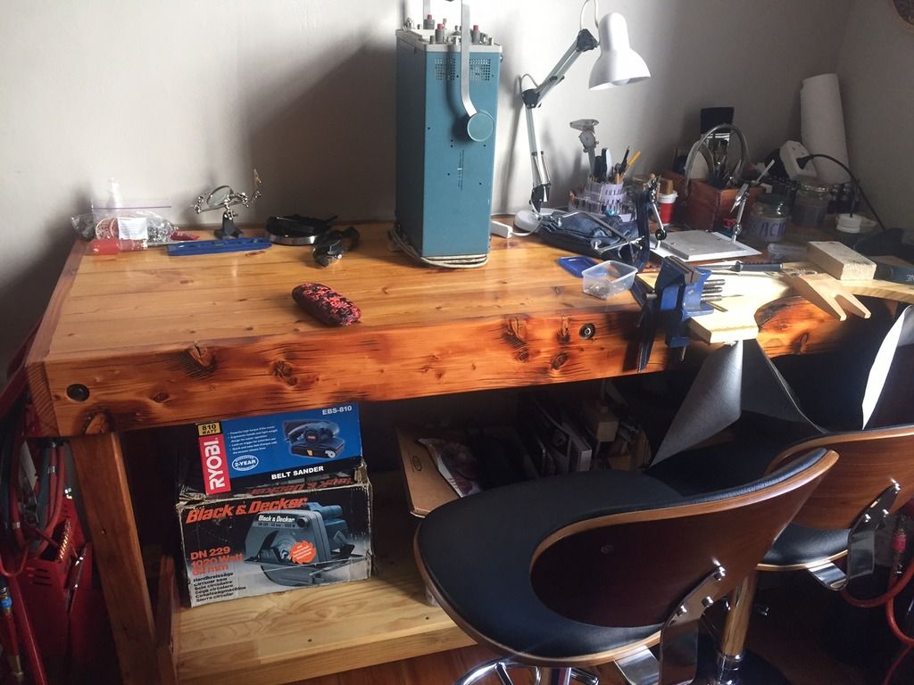

Besides, I put all that effort into building my workbench, so need to use it....
(right half is wife's jewelry work station)

What is the tall blue device?
Offline gavinbirss
Re: DIY project for the year - DAC with valve output stage
« Reply #2 on: January 11, 2017, 04:07:30 PM »
oscilloscope

« Reply #3 on: January 11, 2017, 04:07:40 PM »
^ Oscilloscope?
As other posters said - it's an old school analog Tektronix scope, standing on its back with the front pointing to the ceiling. Modern digital ones look similar from the front, but are about a quarter of the depth and a tenth of the weight  ;D

« Reply #6 on: January 11, 2017, 04:24:39 PM »
It'll get dusty like that
