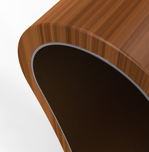

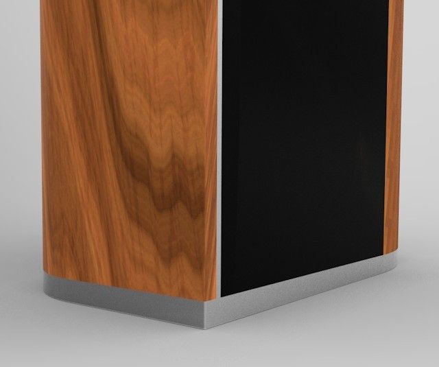

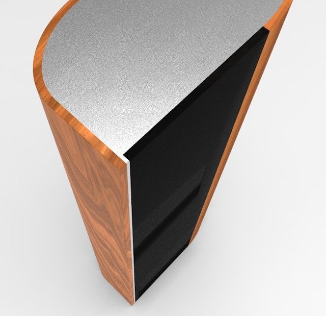

In 2015 I mentioned that we are working on a range of loudspeakers that we will introduce in 2016. It will be an evolution of some of the older Air models, but with a new fresh approach in the design, inside and out, based on new insights gained, new technology and also based on ideas and a clear vision I have on what a loudspeaker should look and sound like. With time, I will provide more details, and even share some of the steps in the production process if there is interest in it. At the moment, these renderings provide a glimpse on what we are working on. We have plans for 3 ranges, all be based on the same building blocks but with different segments of the market in mind. We have  orders for the top model, Air Vivace, of the classical range(still not sure that we will call it a classical range), so that is the priority to bring to life, but hopefully, not long thereafter a statement piece called Air Voice. The focus with all the models will be however on sound quality, style and value.

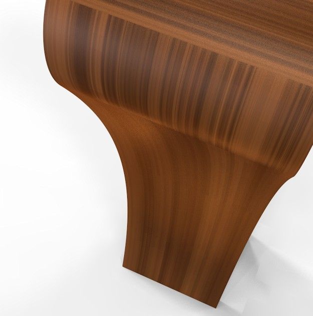

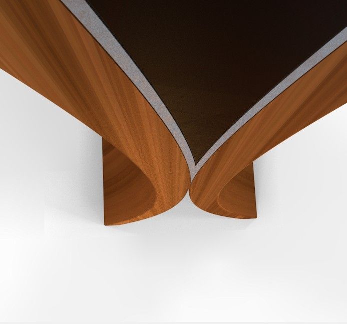

Nidri definitely. There will be at least 2 standmounts available, perhaps 3. The Mezzo will be a medium sized standmount and the Tenor a large standmount. However, both these stands will have dedicated stands. The reason being that the ports will be down firing and we think we have a very elegant design for the stands and there is also a possibility that the base might contain the  crossover. We are still making these final design decisions and the 1st prototype will be a Tenor, so we should know at the end of February.
The cabinets will of the classic range will be  from mainly carbon fibre  with mdf and aluminium components. The cabinets constitute a large part of the cost of the final product and the standmounts prices will reflect the lower input costs,  despite the envisaged integral stands.
