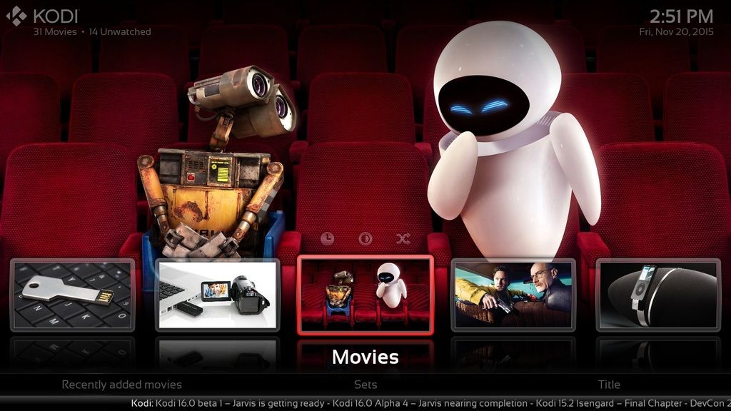

« Reply #15 on: November 20, 2015, 12:40:04 PM »
That's how mine looks like with the standard skin at startup, the link Zealot posted pretty much sums it up.

ooo...thats pretty.
you mean the Kodi skin - wait till you see the other stuff it does ..... just an example
movie selection in "Coverart mode"
TV series in "List mode"
music library in "Icon mode"
Album view in "list mode"
Home page
pretty damn good looking interface when you set the skin up properly .... thanks to Trompie67 for finding the skin  :thumbs: .... i would still be using Aeon nox otherwise, which is not bad but nowhere near as easy to use as this one
