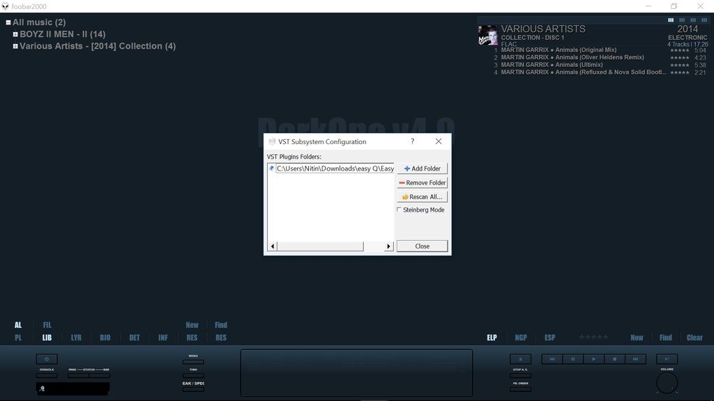

elsewhere we were talking about parametric EQ in Foobar ..... you can do this by adding VST plug-ins using a VST wrapper (VST component for Foobar)
first i added the following .... which is a VST adapter
http://wiki.hydrogenaud.io/index.php?title=Foobar2000:Components/VST_adapter
then i found this thread and i added the George Yohng VST wrapper
https://www.hydrogenaud.io/forums/index.php?showtopic=59206
so im not sure which plug-in caused this but when Foobar opens this is what you see
at this point i closed Foobar and downloaded a parametric EQ called Easy Q and unzipped this
heres the link
http://www.rs-met.com/freebies.html
then i reopened Foobar and when the above screen reappeared i went to the third option ie VST setup and you then point to that EasyQ folder ie wherever it is located
then you close Foobar and reopen and now in the first option ie USE VST EFFECT you select that easyQ option
this then opens up the easyQ equaliser
just above the graph there is a section where you can load or select the factory presets - load is highlighted in red
clicking on load opens the following selection window
heres an example of a factory preset that i just opened
if you wish to manually create your own preset adjusted to your measurements then click on an empty graph point without having any presets loaded and parameters appear on the right hand side that you can adjust ..... for example here i have begun by clicking on creating a peak at 125hz
now you can select whatever frequencies you like or adjust these on the right had side and then you can increase the width of the effect or narrow it etc ..... you are only going to be limited by your understanding of parametric EQ .... im not going to add much detail on that here (i have a more than fair idea and im still experimenting ..... remember im doing all of this on my experimental install and not my final setup  ;) .... so it doesnt affect my final setup till im ready to do so and this is why its best to have multiple portable Foobar installs ie one for each skin and one for experimenting with)
so basically the above just explains how to add parametric EQ to Foobar if you want it ..... it should work with additional VST models of parametric so you can go as easy or advanced as you wish .... EasyQ is IMHO a nice easy beginning point to learn how to dabble in Parametric EQ
