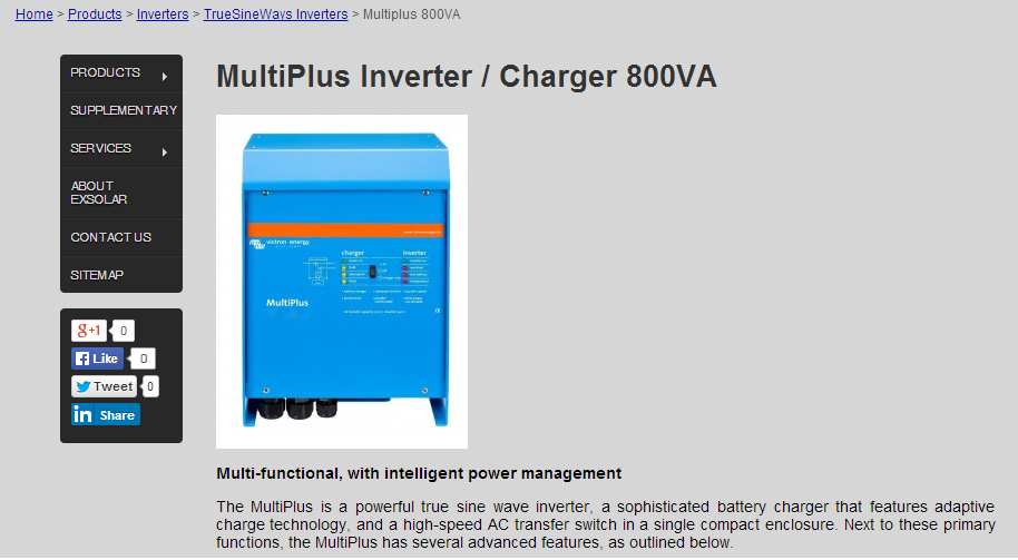

A very good friend is a retired marine electrical engineer and has been involved in substitute and alternative power supplies for many years.  He expressed concern at what he has been hearing from shops who purport to offer solutions to electricity blackouts, and ridiculous prices quoted for solar systems, some over R500k
He suggests the following
For the time being, while the load shedding varies between level 1 and 2, a simple inverter/charger/battery combo will be sufficient for your needs.  The size one you buy will depend on what you want to keep running, but on investigation with many households, an 800VA or 1200VA unit is more than adequate
Should the load shedding become more intense, then you can consider attaching solar panels, but the price will increment by a factor of 5 or more
Batteries are about 80% efficient.  In other words, to extract 100 a/h from a battery you have to pump in 120 a/h.  They also last between 4 and 6 years so must be considered a consumable item
A 24 volt or 48 volt battery conversion system is more efficient than a 12 volt system since the upward multiplication is a lot less.  Large power 12 volt transformers have a lot of wastage within the coils compared with a 24 or 48 volt unit.  Many inverters convert the DC straight to AC, then rely on a transformer to convert this to 220 volts.  The wasted energy will manifest itself as heat
Pure sine wave is much more desirable than modified sine wave, which can be a modified square wave or a trapezoidal wave
After much selection and consideration, he suggests components from this supplier in Somerset West
URL:  http://www.exsolar.co.za/products/
Look at Products / Inverter/chargers and True Sine wave inverters.  They have a sophisticated battery charger which will enhance the life of the battery.  One such unit was purchased in 2006 and still uses the original batteries (2 x 12 volt 40 a/h) after 9 years
There are obviously other equally good devices around, but these are recommended as being the correct device to fit the bill if you do not want to go the generator route and offer the most cost-effective way to provide alternative power at the moment

Neighbour of brother in law in Montagu got a quote for R700k (yes, not R70k) for a 10 kw solar system complete.  Some of these sales people must be smoking something bad...
The Multiplus device is meant to be plugged in to the load and the incoming mains all the time.  The transfer time is 20ms which won't upset a computer and certainly won't upset an audio system or a PVR.  If you use this device in something like a caravan park, where your current load is severely limited, then you can use this to augment the power for short periods to provide more current
