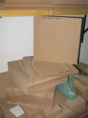

The cross-braces, internal partitions and inner end caps have all received their respective curved grooves for the side panels. This exercise took longer than I anticipated but could have taken much longer without the aid of the router template I prepared earlier.
Here are the groovy panels ready for the next phase:

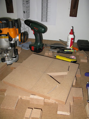

I am busy preparing a router template for the cross-brace vents, had to call it a night in consideration of my neighbours.
Here's a photo of the template taking shape:
I cut the vents oversize to compensate for the 19mm diameter template guide and 12.7mm (1/2") straight bit I'll be using to cut out the vents.
I reckon the enclosures will start taking shape this week ;)

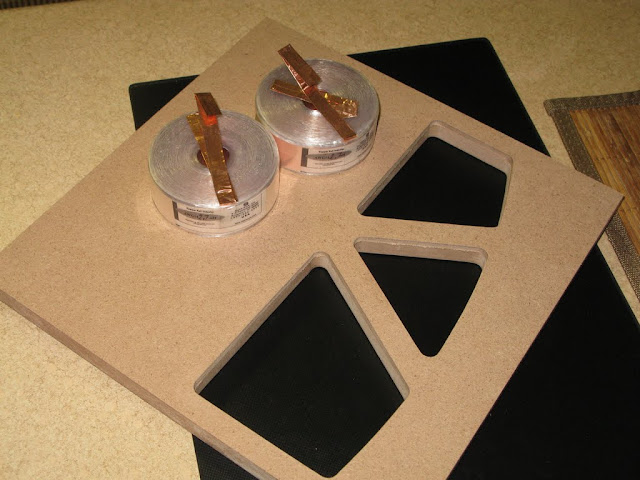

A quick update; I completed the router jig for the cross-brace vents and managed to fit in a test cut before having to call it quits for the night:
Pictured with the test cut piece are the inductors I plan to use for L10 in the 2-way x-over. These are 14AWG 2.7mH copper foil types manufactured by Alpha-Core Inc. Each one of these puppies weigh in at 875g ;)

If you don't mind me asking - how much did you pay for a 2.7mH 14AWG foil inductor?  Must have been on the serious side?
Regards,
Ian.
Thanks Ian :) Yep, it's shame that a large chunk of the effort won't be visible from the outside but I guarantee you that I'll be taking many photos before they are forever entombed ;)
Jigsaws and I have a love/hate relationship, but I suspect it has more to do with the blade used which either cuts true or tends to run about doing it's own thing and ultimately ruining my work (the latter being "clean cut" blades), so I prefer to go the long route to guarantee a more precise cut.
I'll have to check the landed price for the coils for you, but I can list the order line item in the meantime:
(25 August, 2010) 2 x    Goertz CF2.7 (14 AWG) Copper Foil Inductor    $89.56
Shipping came in at $120.14, so you can already see where this is going :-[
