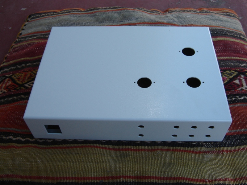

I just got the chassis back from the painter:
I am going to mount all the hardware and post a pic.

« Reply #22 on: February 03, 2011, 07:03:38 pm »
Thanks for the response! The chassis looks really good, can't wait to see how it will look with everything mounted.

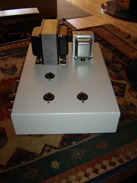

Hi All
Some update on the project.
  • the transformers are completed
  • and mounted
  • tube sockets are mounted
  • electrolytics are mounted
  • busy finalising the layout of the oil caps
I'll post a redrawn schematic soon.

« Reply #27 on: July 13, 2011, 07:57:29 am »
This is looking really good.
